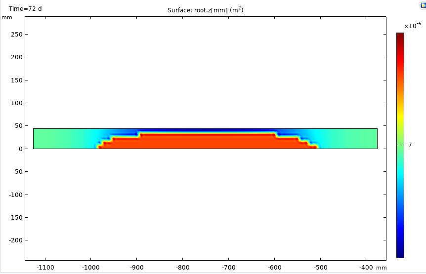

Hi, I am doing simulation and got a results of 2D plot as shown below. I want to extract the output of specific coordinates for example coordinate of (0,-1100), (1,-1100), ... (45, -400) , etc.. Do you know how to extract this information automatically? I know how to use the evaluation features but it is manual and not automatic.
Thank you.

Define a 2D point (or 3D point if your model is 3D) data set in your results node for each point you want to extract values for. Then add a 1D plot group using the new data set as the source.
If the points are in a regular pattern you may be able to use the array type dataset.
