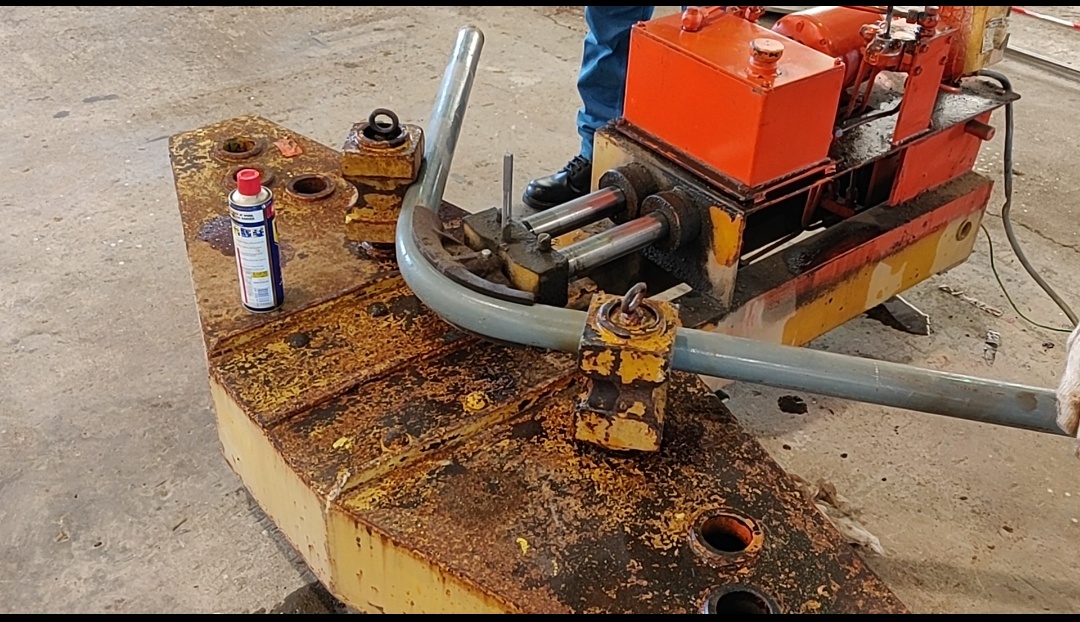

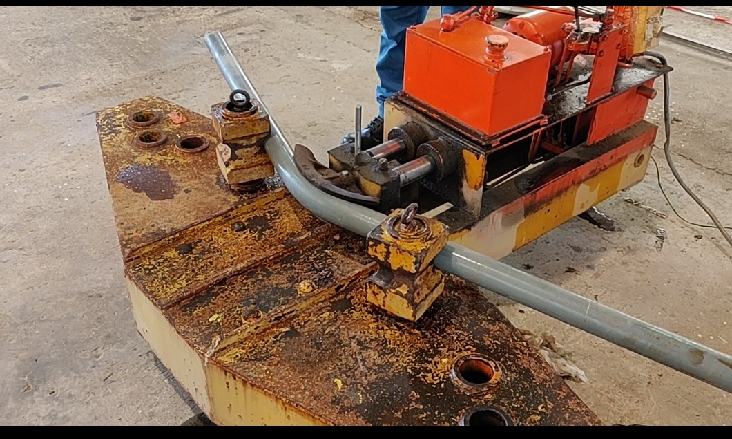

I want to study effect of ram bending of a pipe (as shown in attched image) using FEA on comsol. This will be a static structural plastic deformation using elastoplastic material properties. If anyone could guide me how to model and approach this problem in comsol, it would be really helpful.
