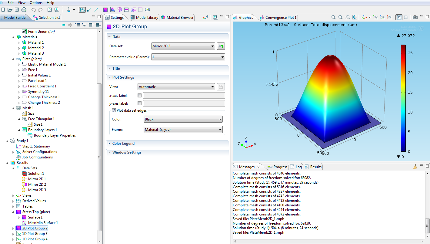

For a 1/8 symmetric model in 2D I have no problems to mirror 3x and get out a full 3D plot (v4.2a)

indeed the mirror implies local symmetry, while the rotation allows to repeat non symmetric shapes
