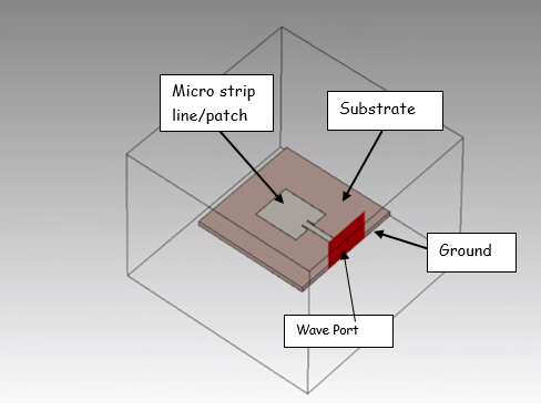

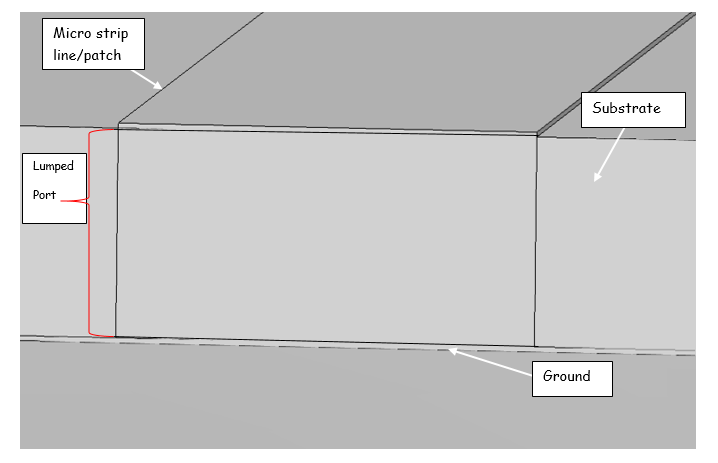

My problem is in CST they were using wave port for exciting the antenna, which was very big and almost floating in the air. In my case, in comsol, i am using lumped port for it. which is very small in size than the waveport of CST.

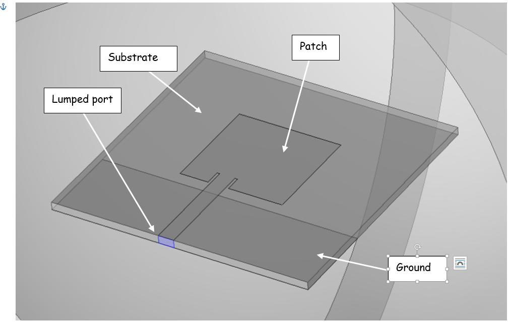

I have attached the microstrip patch antenna model made in comsol and CST below.
Just to highlight again:- My problem is, i am using the same parameters to model an antenna in comsol and CST, the results (S11 = -20dB, directivity in particular direction) obtained in CST are good. However, in comsol its very different (S11= -15dB, directivity spread all side).
The only difference that i can see in both the models is this wave port used in CST, shown in the attached file. As you can see in the diagrams, the wave port is somewhat floating in the air. I don't know where is wave port in comsol.
So, in comsol, I am using lumped port as shown in attached file. The volatge used is 1[V] and input impedence is 50 ohm.
Please help.

The Comsol1 picture seems to show that the ground plane is only under the feed line and not under the patch. A patch antenna needs a proper ground plane.

Hello sir edigar,
I make the ground plane partial to have the wideband. If i make the groud plane size of substrate then the anteena becomes narrow band.
