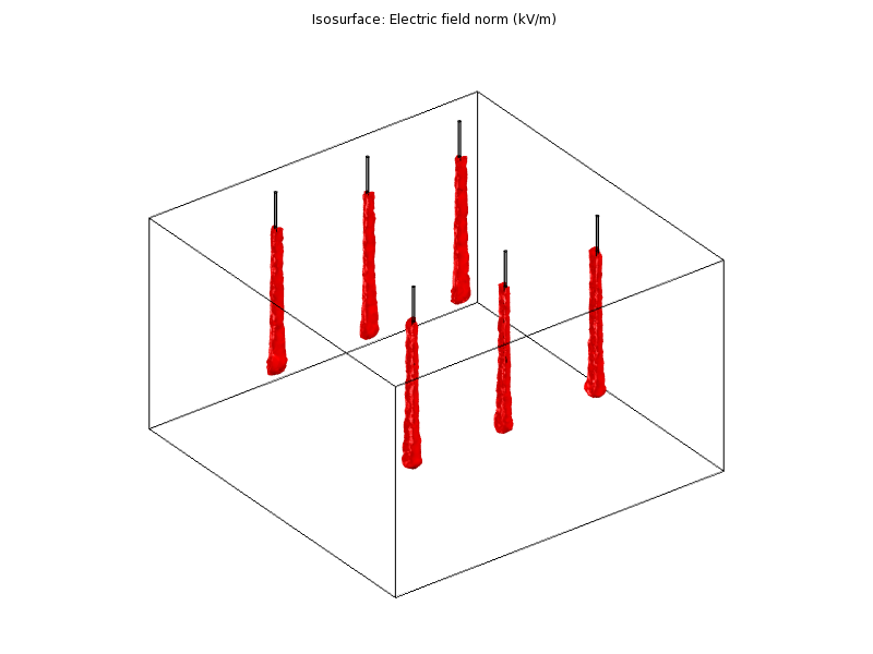

Hi.
Currently, I'm doing simulation to investigate electric field distribution on biological tissue electroporation. I already have the electric field distribution as depicted in attached file "isosurface plot.png". After that, I want to calculate the volume bounded by the red surfaces near the needle electrodes. Anybody can share with me how to do it? I'm completely newbie for this software. I already tried using Volume Integration in Derived Values, but I have found nothing what I want. If this calculation might need another it is ok then.
I really appreciate any comment for this question. Thanks in advance
Iqbal

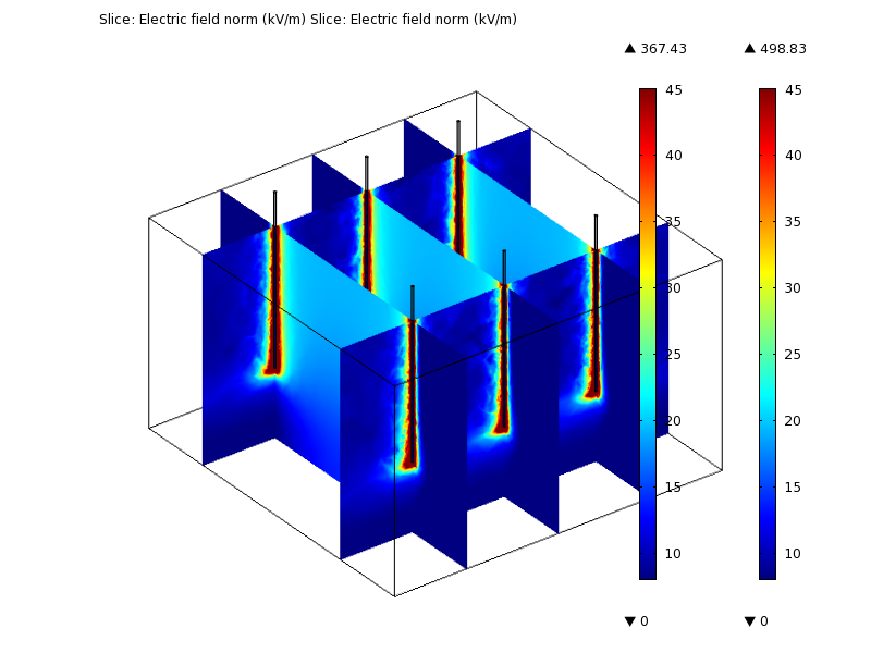

to visualize the electric field distribution and make the volume I want to calculate clearer, I attach a file "slice plot.png".
thanks

Use the volume integral but type in "es.normE>30e3" as the argument. This is a Booelan expression that will return 1 when the E field >= 30e3 V/m and zero when it is < 30e3. The integral will evaluate to the tissue volume inside the 30e3 V/m isopotential surface.
Niklas
