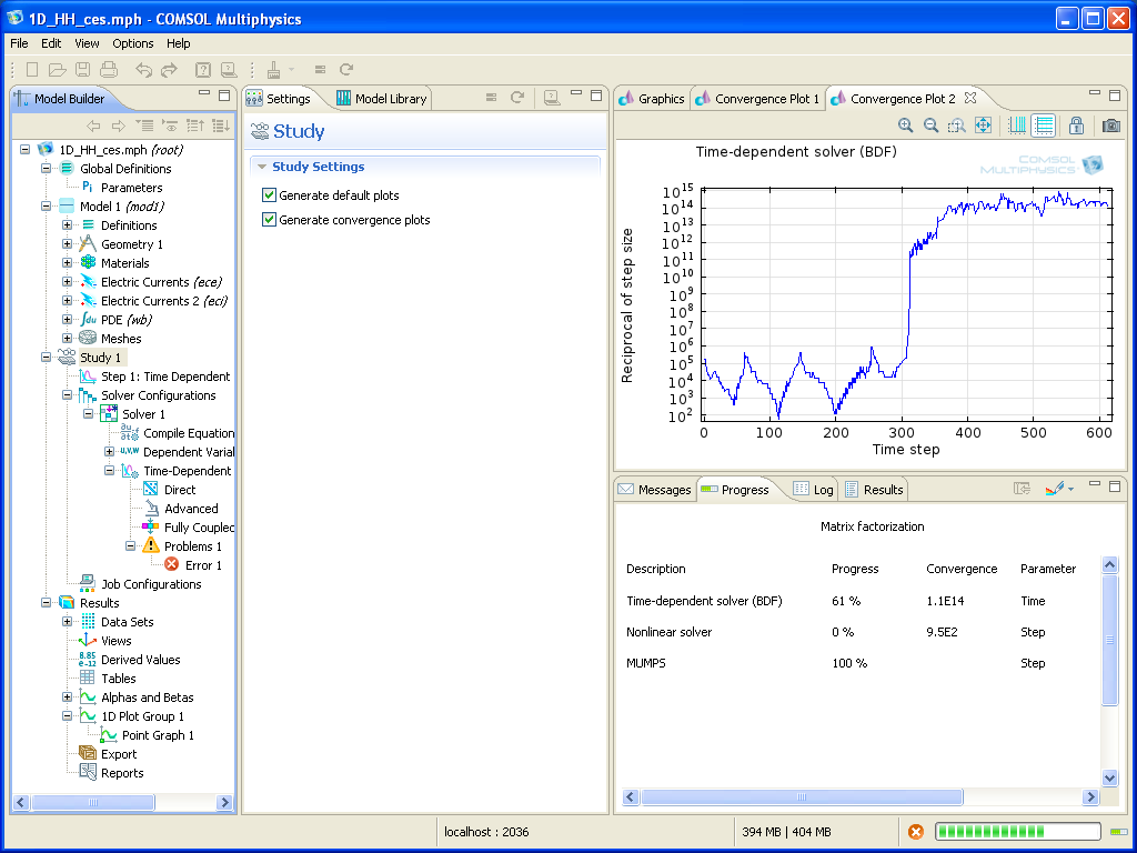

I have the same general symptoms as above: Time-Dependent solution proceeds fine for some time. Then, all of a sudden, the "Reciprocal of step size" on the convergence plot goes to 10^14 and stays there. (See attached convergence plot.)
Some supporting information:
• Sometimes, after thousands of time steps all around 10^14 it says "The following feature has encountered a problem: Repeated error test failures. May have reached a singularity. Time: .... Last time step is not converged. - Feature: Time-Dependent Solver 1 (sol1/t1)"
• Changing the BDF time-stepping to Strict and decreasing the maximum step size arbitrarily, still leads to this error.
• The behaviour of trying to terminate the process (as it's obviously not making much progress towards terminating, if it goes in time steps of length 10^-14) is (whether I press the round red button with a white cross on the status bar, OR use the Stop buttons on the Progress tab) that the convergence plot accelerates (!) and so does the activity in the Progress tab, while CPU activity goes to zero on all but one CPUs. I'm interpreting this as a bug where it's trying to process results coming in from the server after I cancelled the simulation i.e. I don't need the results.
• See the convergence plot attached.

My question is: how can I find out which of the dependent variables (I have 4) fails the error test (which is what must be driving the time step to very small)?
• This happens in stand-alone Comsol, as well as running in client+server mode.
• Not a memory issue: Comsol is using under 400 MB, and there are 2+ GB of system memory available if it wanted.
This affects only the BDF solver. Switching to Generalised Alpha avoids the problem behaviour.
