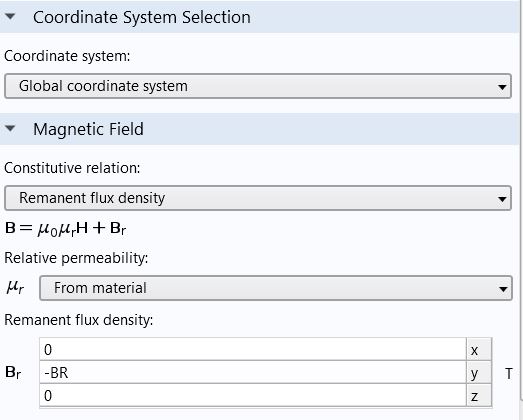

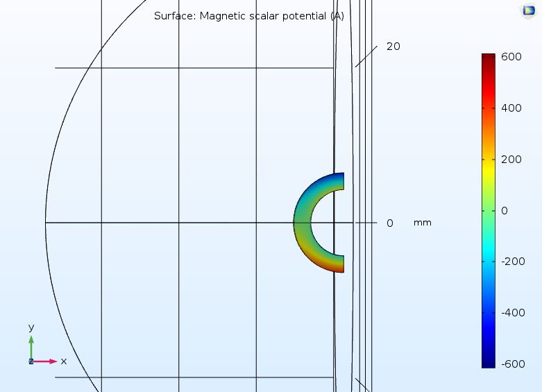

Currently I am working on half ring magnet with diametrically magnetization simulation, the magnetization is attached as below.
However, I have the problem to magnetize the magnet to get the expected result, the magnetization direction and result are also attached. I am thinking to use formula to handle the direction, but after many trial still not work.
May I ask if there is any possible solution for this? Thanks in advance.

Andrea,
it looks like you want a horse-shoe like magnet. In this case it is better to define a cylindrical coordinate system and define the magnetization in the phi-direction.
Cheers Edgar

Thanks Edgar, it is solved.
