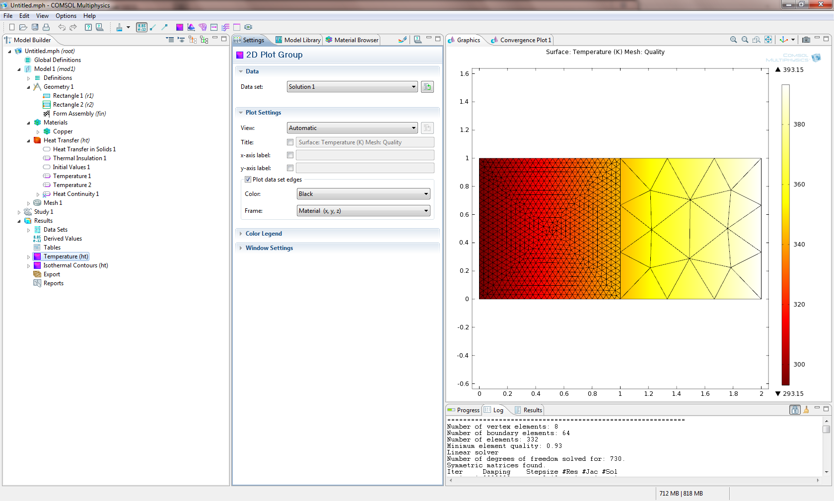

It's indeed possible. The "trick" consists in using an assembly and an identity pair. See the attached screenshot for an example illustrating that approach.

Posted: 1 decade ago 27 juin 2011, 16:15 UTC−4
Sorry, he it is.
Sorry, he it is.
