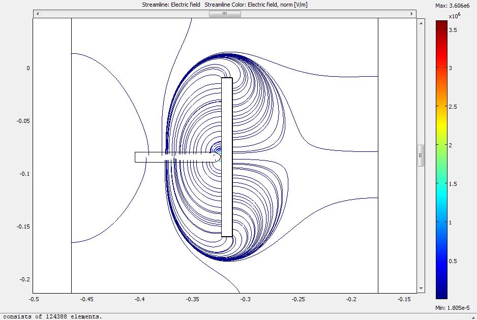

Posted: 1 decade ago 5 avr. 2011, 11:22 UTC−4
hi Edgar,
i attach a photo so you can picture. there are 2 metal electrodes in a room with air at low pressure.
i am doing the simulation for various diameter of the electrode point, and i need to see if the distribution of the electric field changes or not.
and if it does, i need to calculate the length of the field line, and the angle between the lines and the symmetry axe. after that i have to compare how it changes the electric field with the angle.
hi Edgar, i attach a photo so you can picture. there are 2 metal electrodes in a room with air at low pressure. i am doing the simulation for various diameter of the electrode point, and i need to see if the distribution of the electric field changes or not. and if it does, i need to calculate the length of the field line, and the angle between the lines and the symmetry axe. after that i have to compare how it changes the electric field with the angle.
Posted: 1 decade ago 5 avr. 2011, 12:26 UTC−4
hi, to be more explicit,
at low pressure, the electrons follow the electric field lines where they may encounter on their way other molecules to
make collisions so there can be a discharge between the 2 electrodes in the picture. so the electrical breakdown occurs
along the field line. so i need to know for what length of the field lines the breakdown occurs.
i am just assuming that the field lines don`t change with the pressure.
the electrode point has a electric potential of 3600V and the other electrode and the room are grounded.
and i really hope you can help me because i am a bit out of time.
honest thank you, Georgeta
hi, to be more explicit, at low pressure, the electrons follow the electric field lines where they may encounter on their way other molecules to make collisions so there can be a discharge between the 2 electrodes in the picture. so the electrical breakdown occurs along the field line. so i need to know for what length of the field lines the breakdown occurs. i am just assuming that the field lines don`t change with the pressure. the electrode point has a electric potential of 3600V and the other electrode and the room are grounded. and i really hope you can help me because i am a bit out of time. honest thank you, Georgeta
Posted: 1 decade ago 6 avr. 2011, 04:14 UTC−4
Georgeta,
probably the field lines indeed do not change with pressure, because this doesn't change the dielectric parameters of your partial vacuum very much.
But as soon as you have an electric breakdown you will create a plasma and things will change dramatically. You will have a cathode sheeth and all those plasma discharge phenomena. So, electrostatics only helps you until breakdown. Afterwards you need to deal with plasma.
Isn't the local field strength the major quantity for electric breakdown? Without a breakdown the electrons travel along field lines. But the breakdown will start where the field is maximum and at a certain distance from the cathode (cathode sheeth). After breakdown field lines have little meaning because of all the plasma around.
I assume if you really want to calculate the length of field lines you will need to modify the application module and introduce the equations for integrating the electron trajectories. This is something I know can be done but I haven't done it so far.
Cheers
Edgar
Georgeta, probably the field lines indeed do not change with pressure, because this doesn't change the dielectric parameters of your partial vacuum very much. But as soon as you have an electric breakdown you will create a plasma and things will change dramatically. You will have a cathode sheeth and all those plasma discharge phenomena. So, electrostatics only helps you until breakdown. Afterwards you need to deal with plasma. Isn't the local field strength the major quantity for electric breakdown? Without a breakdown the electrons travel along field lines. But the breakdown will start where the field is maximum and at a certain distance from the cathode (cathode sheeth). After breakdown field lines have little meaning because of all the plasma around. I assume if you really want to calculate the length of field lines you will need to modify the application module and introduce the equations for integrating the electron trajectories. This is something I know can be done but I haven't done it so far. Cheers Edgar
