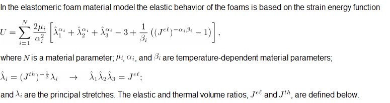

Hi. I have a similar problem.
I'm modelling a material with a foam type of behavior and would need a material model to characterize the compressibility.
The problem is that foam models are in terms of the principal stretches which seems to be a little hard to get a hold of in COMSOL.
Have anyone been able to implement a similar model and willing to share some tips i would be truly grateful.
Thank you!
Hi. I have a similar problem. I'm modelling a material with a foam type of behavior and would need a material model to characterize the compressibility. The problem is that foam models are in terms of the principal stretches which seems to be a little hard to get a hold of in COMSOL. Have anyone been able to implement a similar model and willing to share some tips i would be truly grateful. Thank you!
Thank you!
The model shown in the attachment to this question is now (from version 4.3b) available as the 'Storakers' model.
Henrik
Hi, This is an old thread, but I still add some comments to it: [QUOTE] Are there any talks about COMSOL implementing other hyperelastic models like Yeoh, Ogen or Arruda-Boyce? [/QUOTE] Yeoh, Ogden and Arruda-Boyce materials are all available. [QUOTE] Hi. I have a similar problem. I'm modelling a material with a foam type of behavior and would need a material model to characterize the compressibility. The problem is that foam models are in terms of the principal stretches which seems to be a little hard to get a hold of in COMSOL. Have anyone been able to implement a similar model and willing to share some tips i would be truly grateful. Thank you! [/QUOTE] The model shown in the attachment to this question is now (from version 4.3b) available as the 'Storakers' model. Regards, Henrik
