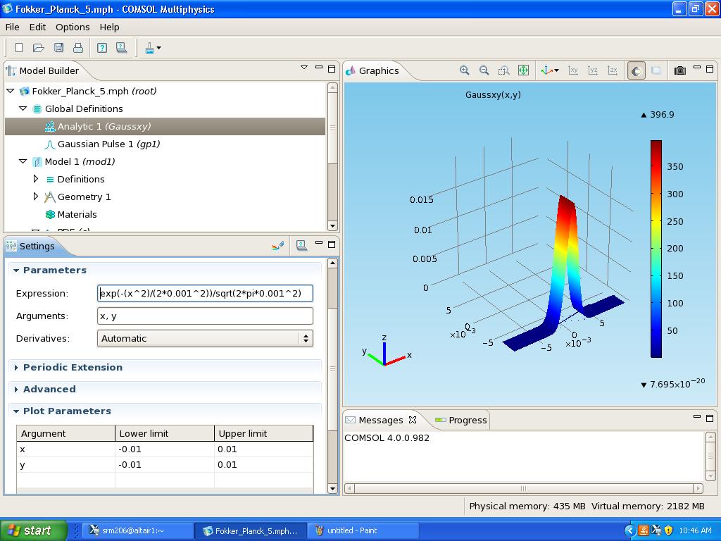

Thank you very much for the reply. I am still having problems with that. The formulas that I have written
u(x,y,t=0)= exp(-(x^2+y^2)/(2*0.001^2))/(2*pi*0.001^2)
is already normalized. I have attached the Jpeg files of the distributions that I got with this message.
When I plotted
ux(x)= exp(-(x^2)/(2*0.001^2))/sqrt(2*pi*0.001^2)
gives a good Gaussian plot in x (COMSOL_Gauss_X.JPG).

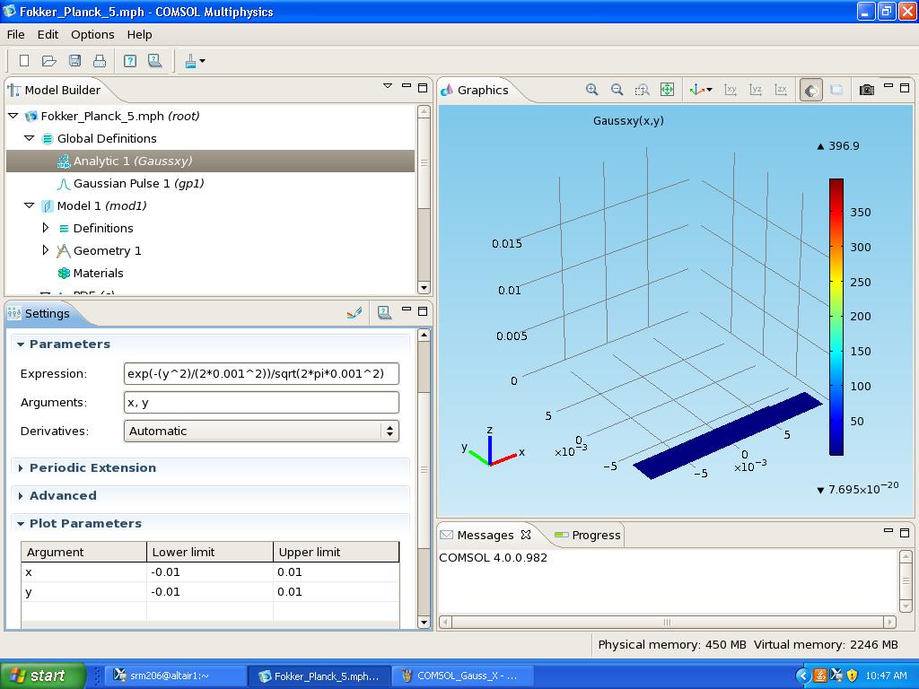

But when I plotted
uy(y)= exp(-(y^2)/(2*0.001^2))/sqrt(2*pi*0.001^2), it gives wrong result. (COMSOL_Gauss_Y.JPG).

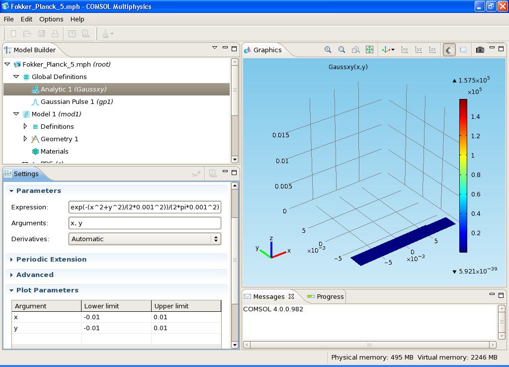

also when I plotted
u(x,y,t=0)= exp(-(x^2+y^2)/(2*0.001^2))/(2*pi*0.001^2) gives wrong result.
Could you please have a look at the images that I have attached with this message.

I got a reply from COMSOL support team, they could plot the function correctly as shown in the Figure attached with this message. But I could not get the same result... I think there is something wrong with my graphics or rendering...

Hi Ivar,
Thanks for the help. It is a problem of 3D Rendering. I had to change the option to software as below.
as told by COMSOL support team
"Options > Preferences > Graphics" and under "3D rendering:"
select "Software" and click "Apply"
Now it shows correct distribution as shown in the attached figure.
