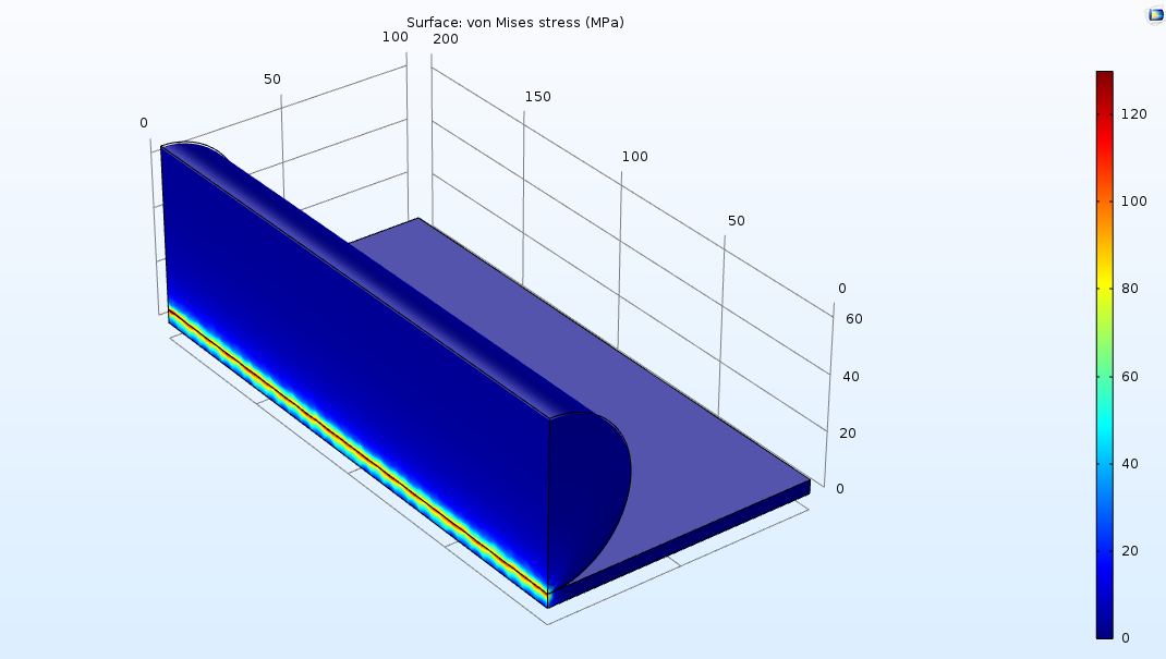

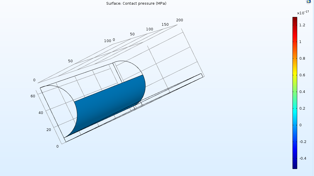

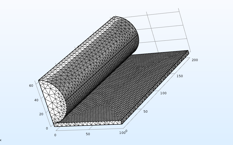

Hi Henrik,
Thank you for your reply. Since the problem is symmetric (cylinder and plate), so I modeled half of them in 3D and set up properly boundary conditions. It runs successfully. There is no point load at the middle of the cylinder, so I just use edge load instead.
However, the stress and contact pressure are just so low as in pictures.
I don't really understand why the results are wrong, even though it runs successfully, and the mesh seems fine enough.
Thank you
Yen
