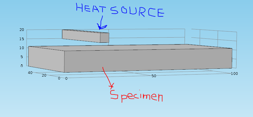

I am trying to model two bodies in comsol, one is the heat source and the other body represents a specimen. The heat source is going to heat up the specimen. The model is explained in the attached image file. I am using Heat Transfer in solid module.
I have two Questions:
1) As I am transferring heat from one body to another, so I have to take into account surface to surface radiation but I tried different options and am unable to heat up the top surface of the specimen. And how I have to define in Comsol that in the surrounding we have air.
2) Once I am able to heat up the specimen top surface using the heat source, my next step is to move the heat source along the specimen in the x-direction. I want to know that which physics I have to use for that and how can I do it?

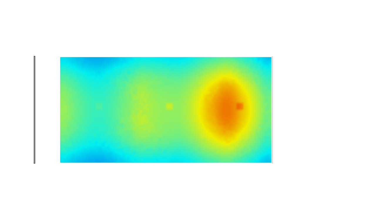

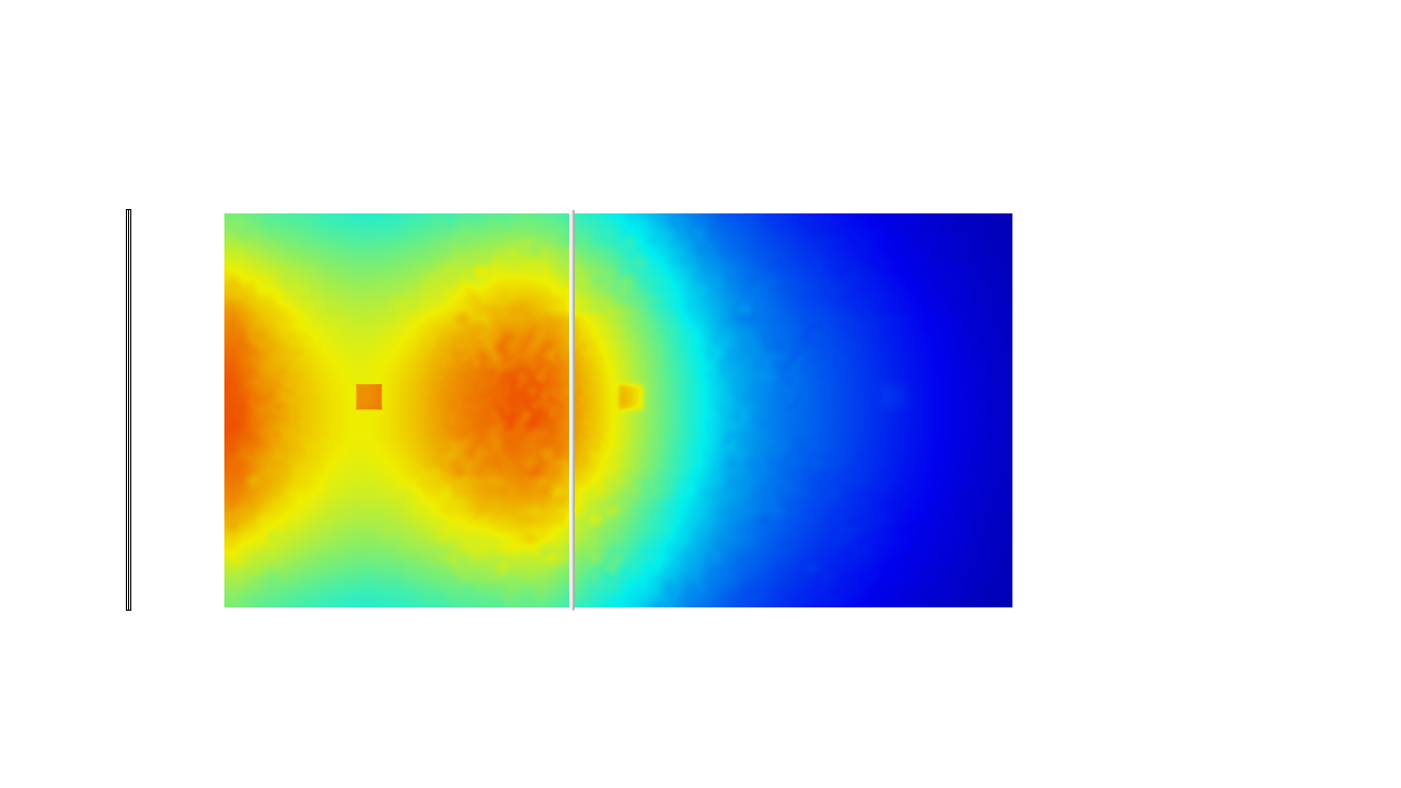

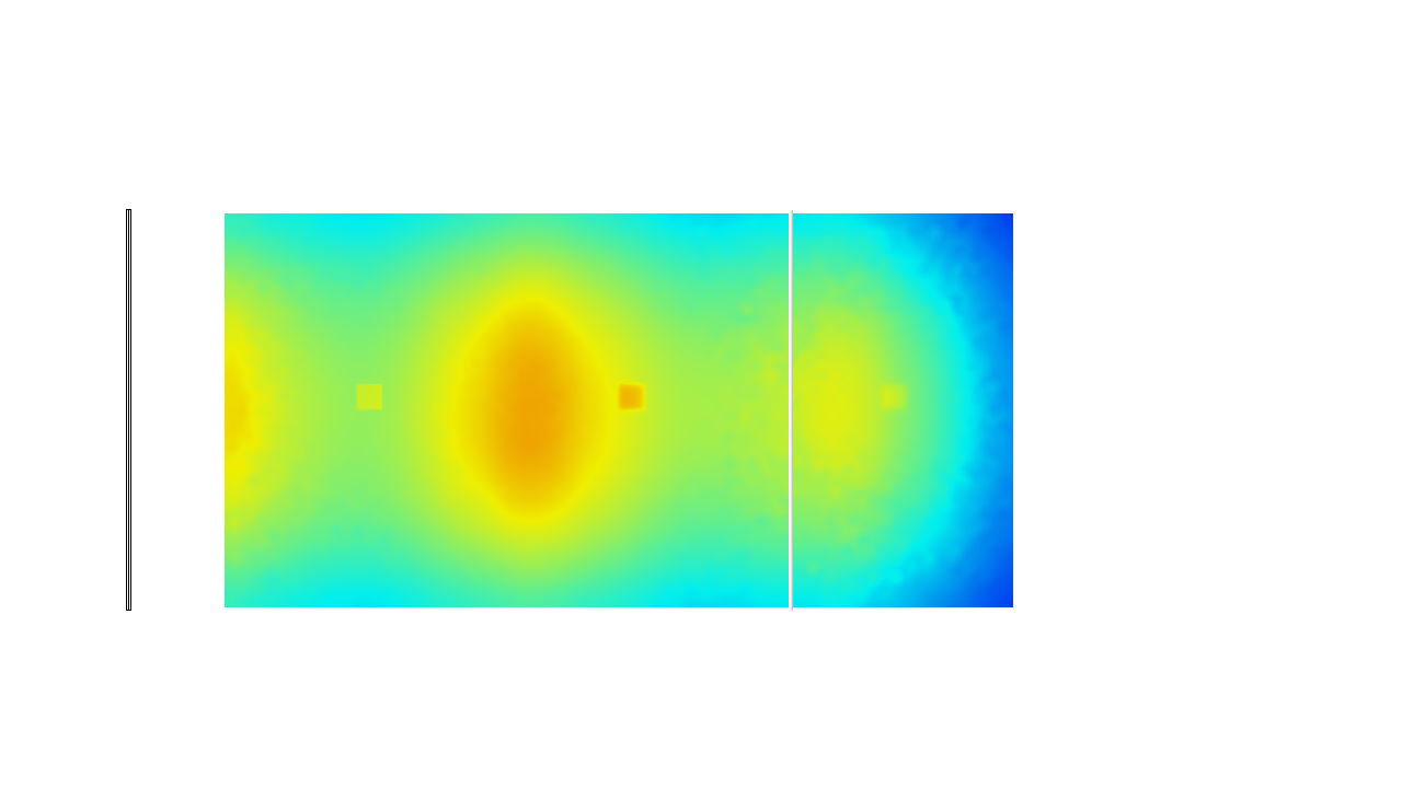

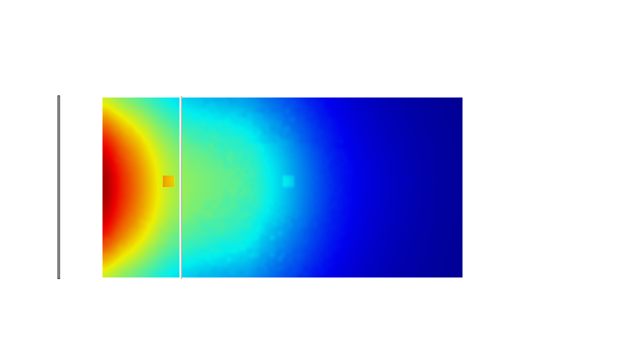

I am using moving mesh to move the rod(heater) over the specimen which seems is working fine. But the only issue I am facing now is the effect due to speed of heating rod. The heating rod diameter is 2mm and the time step for the simulation is Dt = 0.05. I am doing a parametric study with velocity equal to 20mm/s, 40mm/s and 60mm/s. For 20mm/s speed The heat flow on the specimen with the rod consistent. But if I increase speed to 40mm/s or 60mm/s it lags as can be seen in attachment.
I was going through your reply again and I think I should change the time step according to this (i.e. Dt=~D0/(2v0) ). Am I right? and please can you explain the concept behind selecting time step according to this equation?
Also, my simulations are taking very long time i.e. nearly 7hrs. I tried to change mesh and solver from BDF to Generalized alpha but it didn't help. Please guide me in this regard too if you can suggest that how can I speed up my simulations.
