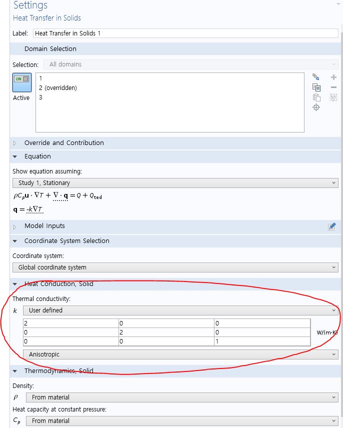

In my study, I should calculate the flow behavior with cylindrical anisotropic viscosity.
So, the radial, azimuthal, and z-direction components of viscosity must be designated, separately.
ex) mu=[2 0 0 ; 0 1 0 ; 0 0 1] in matrix form

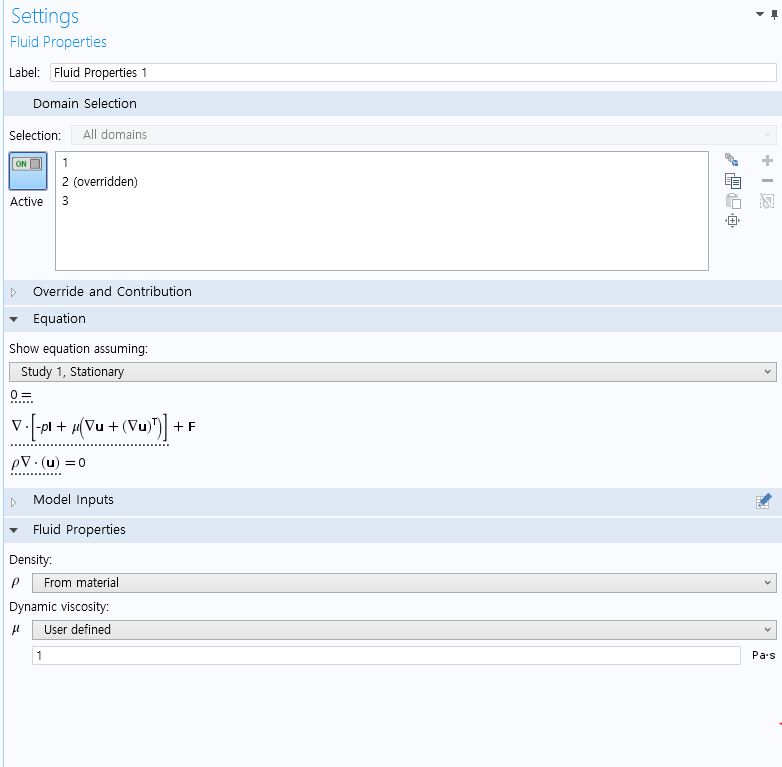

Unfortunately, dislike other physical modules, such as heat transfer (in attatched figure 'heat'), CFD module does not allow to use 'vector-form' anisotropic input variables (in attatched figure ' flow').
Could u suggest a good idea to solve this problem?
or recommend the other method to handle this?
I tried to build up stokes equation using 'coefficient PDE interface', but it is not easy to optimize and utilze the same as to results of CFD module..
