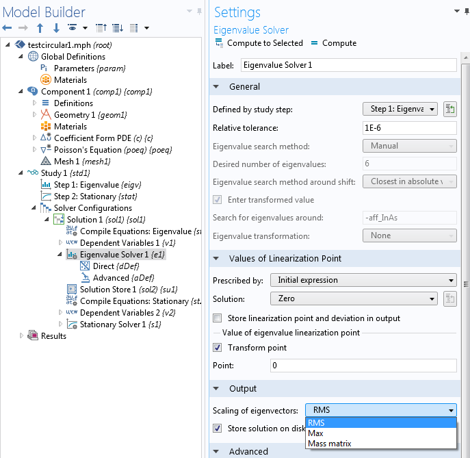

You cannot create your own eigenvector scaling. You can only choose between the three built-in scales as shown in the attached screenshot. The default is to set the RMS of all degree of freedom values to 1.
Henrik
Hi, You cannot create your own eigenvector scaling. You can only choose between the three built-in scales as shown in the attached screenshot. The default is to set the RMS of all degree of freedom values to 1. Regards, Henrik
