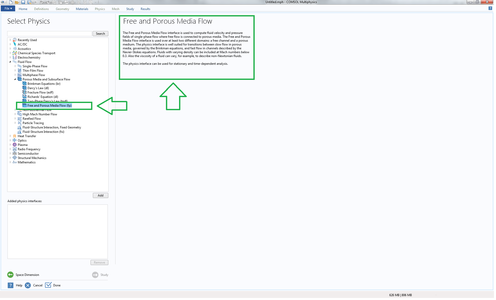

Depending on which licenses are included in your license, you may have access to a physics interface called "Free and Porous Media Flow" (see screenshot), which would make coupling of the (free) flow in the cannula to the flow in the (porous) adipose tissue much easier than doing it "by hand". If you do have access to that physics interface, you will find various tutorials for it in the Applications Libraries (under the File menu in the software) and Application Gallery (on the COMSOL website).
Hello Theodore, Depending on which licenses are included in your license, you may have access to a physics interface called "Free and Porous Media Flow" (see screenshot), which would make coupling of the (free) flow in the cannula to the flow in the (porous) adipose tissue much easier than doing it "by hand". If you do have access to that physics interface, you will find various tutorials for it in the Applications Libraries (under the File menu in the software) and Application Gallery (on the COMSOL website). Best regards, Jeff
