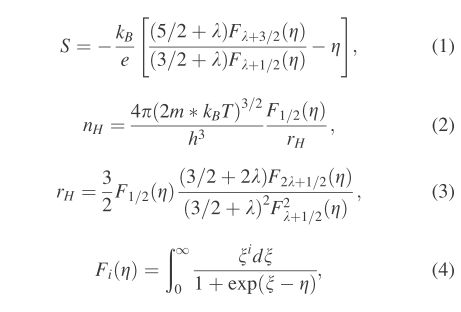

Hello, To be honesty i have no idea about MATLAB programming code.
Below i attached equations, how to perform the below equations and help me programming code. I know two parameters ( S and nH values), by using these two parameters i want to find the effective mass value.
Please help me regarding this problem

My name is Rebeca and I am a posgraduate student. My research is about thermoelectric materials, and, as you did, I am trying to calculate the effective mass from some Seebeck and Hall effect measurements. Can you please tell me how did you do that?. As far as I know I have to solve the Fermi integral. to calculate Fermi reduced level, and use this value to calculate m*, but I am not to sure how to do this.
