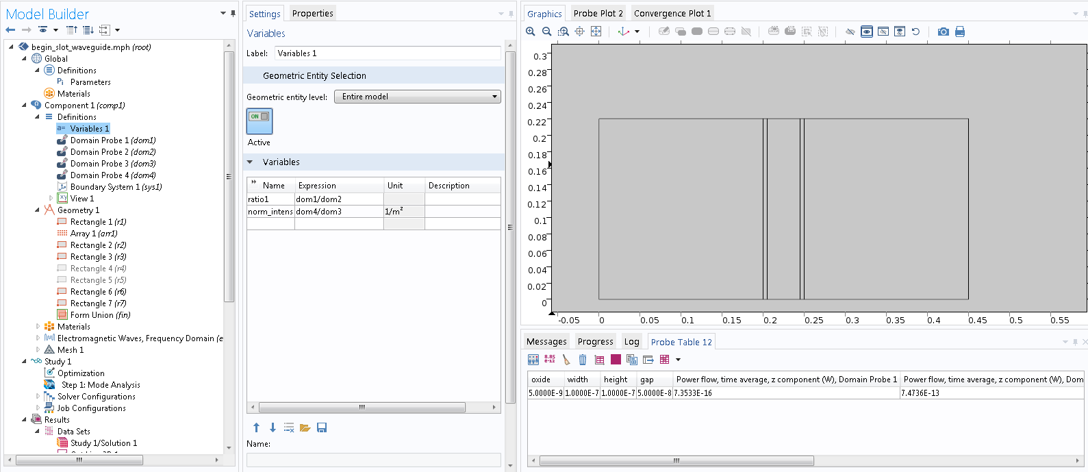

In the attached image you can se how I set it up.
A quick summary:
under definitions I have variables, domain 1, 2, 3 and 4.
In variables I have a variable called ratio1 which is basically domain 1 divided by domain 2.
Now in the optimization I try to maximize this variable ratio1
as parameters I have set 3 parameters which have a upper and lower constrain.
When I run this I get an errror saying:
Error in sweep. Failed to evaluate expression
Or it doesn't change the values I've set under Global->definitions->parameters

Hi, Bob
I met the same question with you, and now it is solved.
Instead of writing a express of "ratio1" in the objective function directly, you could try to click the "+" which is on the top right corner of objective function, then add the express of "ratio1" in variables.
Hope that it can help you.
Ze.
Hi, Bob I met the same question with you, and now it is solved. Instead of writing a express of "ratio1" in the objective function directly, you could try to click the "+" which is on the top right corner of objective function, then add the express of "ratio1" in variables. Hope that it can help you. Ze.
