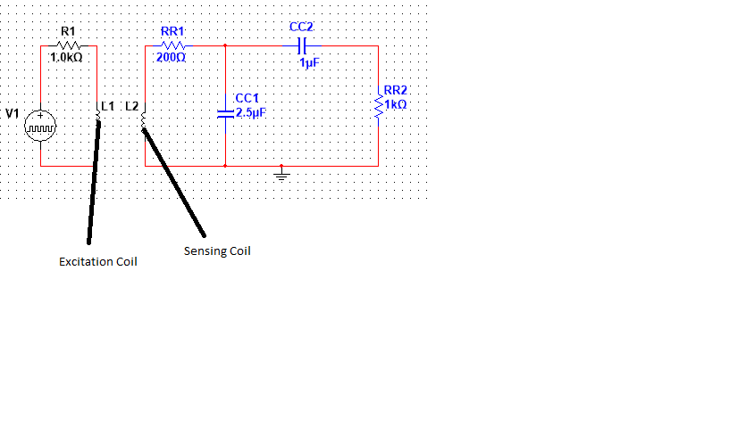

Hello sir
According to my model i have to wound a excitation coil in both sides of the toroidal core which should be connected together. Would you please suggest me how to connect this two coil? Another issue is to coupling with circuit. Therefore, i have to couple the sense/secondary coil with the band pass filter circuit. So my doubt here is how to define the nodes? Here, i have attached the circuit photo.
Hello sir

8 avr. 2015, 11:45 UTC−4
Please send your COMSOL model - if you do not want to share it in the forum feel free to contact us diorectly through support@comsol.com.
