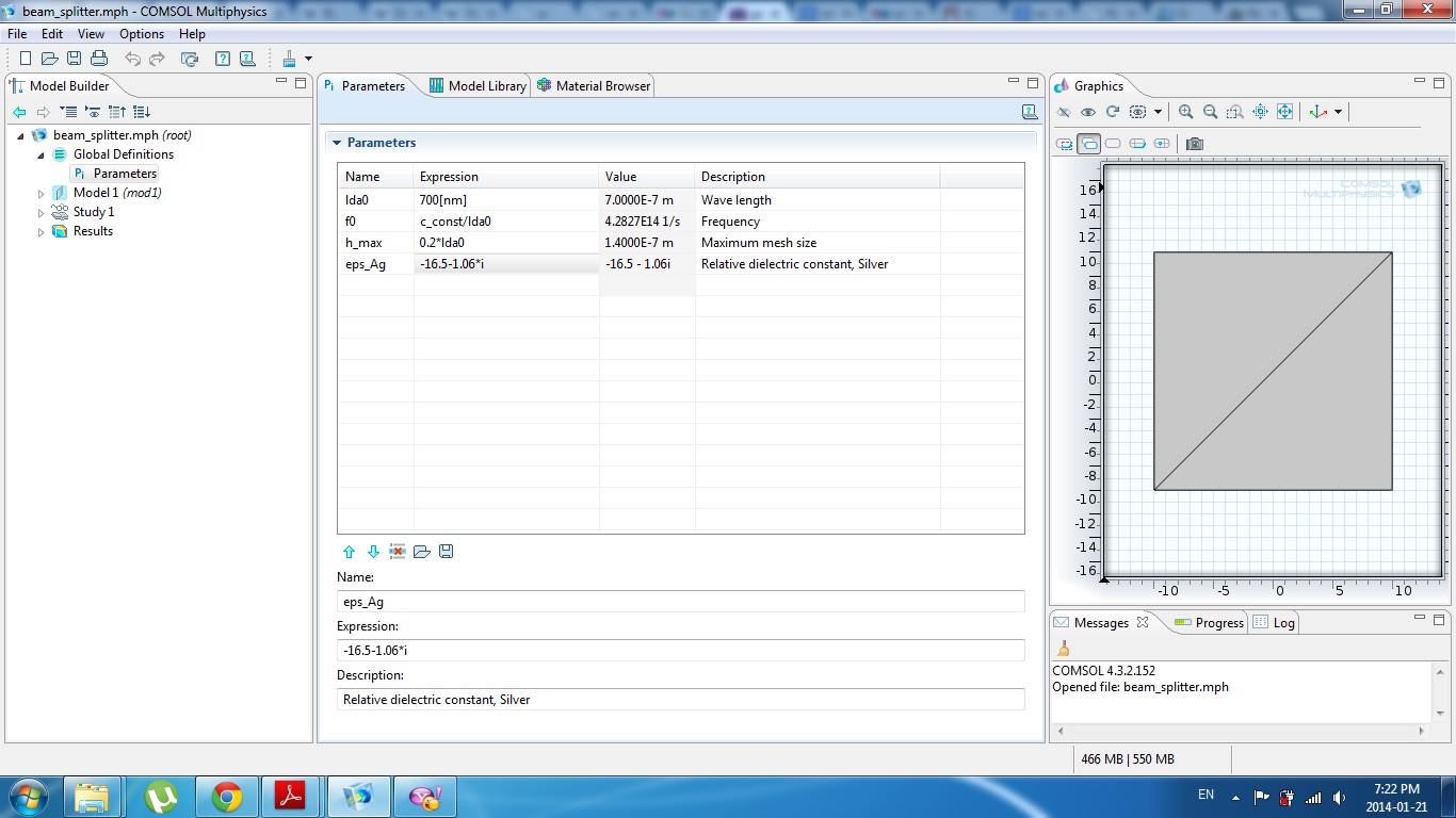

I am trying to implement a beam splitter configuration in COMSOL, but I'd like to use Gold, Aluminium or Chrome instead of Silver. The default COMSOL implementation uses Silver, with the relative dielectric constant: epsilon = -16.5-1.06*i. I need some similar values for the other three metals...
Do you have any idea for my situation? I searched all over the internet, but without any results... :( How could I determinate the relative dielectric constant (even if they are complex numbers) for Gold, Aluminium or Chrome?

a little Google search using 'permittivity of gold at optical wavelengths' already yields many hits. Among many others this one: fisica.ufpr.br/jfreire/EstadoSolido/optical%20contstants%20of%20noble%20metals.pdf
which should already answer your questions. It also describes how to measure the complex permittivity. And keep in mind, it is very frequency dependent in the optical domain.

The site refractiveindex.info/ has data files to download, which can easily be input into an interpolation function that defines your frequency-dependent permittivity or refractive index. The 1972 data from Johnson & Christy is available, for example.
