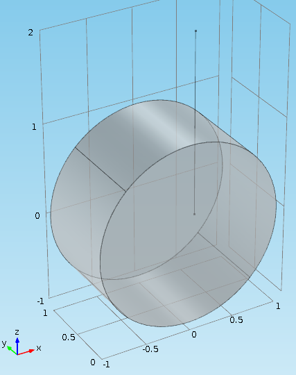

Here is a way to do it. Under the Geometry, you can define a parametric curve that is a vertical line (no variation in the z-dir) that intersects the parametric surface at the correct x,y location. Then, use the new partition Boolean functionality to create a point at the intersection. In this way, you don't have to know the exact z-location. COMSOL will calculate it for you.
Be sure to click on the "Select Points" filter icon at the top of the Graphics window to visualize that indeed a point has been created on the surface.
See attached *.mph file. And, screenshot.

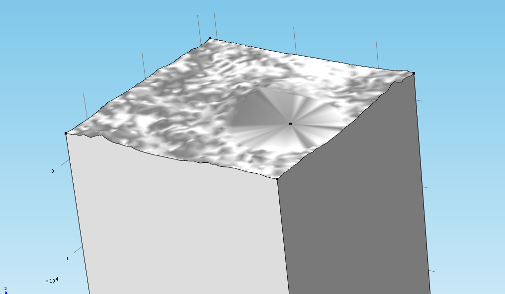

Thanks again. I tried a similar technique with a line and then deleting entities. This partition tool seems to do the same thing. It works in that it creates a point on the surface in the correct place. However it also impedes the interpolation of the parametric surface in the immediate area. I've attached a screen shot to show what I mean.
Do you know a way around this?

Hmmm.... the only thing I can think of is adjusting the "Relative repair tolerance" on the Partition Boolean operation settings window. Judging by the screenshot you sent over, I'd suggest reducing this value although you could try both increasing and decreasing and see what happens.
I'm interested to know how it goes.

I've just tried values between 1.0e-2 and 1.0e-100 but there was no change in the resulting geometry unfortunately. With a value of 1.0e-1 the geometry of the surface more resembles what it should be, but the point is no longer on the surface and the shape of the block becomes seriously deformed (no longer cubic!).
I've sent a request to COMSOL support so hopefully they'll come up with something smart.
