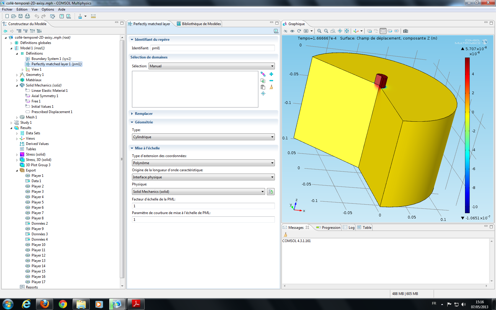

I'm using a model of a small rectangle onto a large rectangle 2D axisymmetric
to denote of wave propagation
I have to put the PML absorbed wave to not be reflects
But when i put it and i do the compute
I don't see a difference => PML like does not work !
can you help me please ? what do I do?
note:
-> Model Wizard -> 2D axisymmetric -> structural mechanics -> solid mechanics -> temporel
-> Definitions -> PML
I have searched through the documents COMSOL a model that contains a sample of the PML but I have not found.

beware! PMLs are defined only for harmonic analysis. For transient analysis, please use infinite elements (COMSOL version 4.3 and later).
This is not specific to structural mechanics, but also valid for other physics.
More information may be found in Help > Documentation > Search > infinite elements

Actually, the search for "infinite elements" returns a lot of information, so my first answer was too general. Here is a more specific answer for structural mechanics: please check the chapter "About the Low-Reflecting Boundary Condition" in the MEMS or Structural Mechanics Module documentation.
Please also not that, under some circumstances, a periodic boundary condition might also be helpful. For instance:
www.comsol.com/showroom/gallery/9903/
