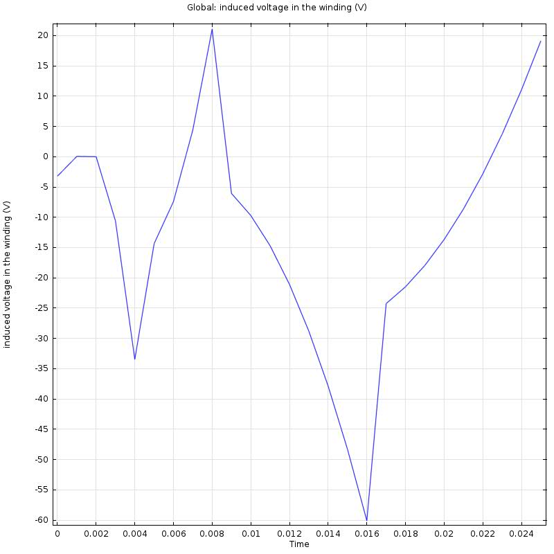

at 127 rpm and 32 poles it takes only 0.015s to rotate from 1 pole to the next. Is your time stepping too coarse and you are observing just an aliasing result?
Cheers
Edgar
Cheers
Edgar

As i said i am using for time stepping "linspace(0,0.03,30)". I have already increased it for linspace(0,0.03,100) but the bad induction presists. I thought that with more steps the problem should be gone but it didn't. Is this what you are suggesting?
Do you think that i should increase it even more?
Thank you for you reply.
José Cardoso
José Cardoso

Sorry, I got the syntax of linspace confused. The time stepping is probably ok. You might still check if you chose explicit timing in the solver.
Another issue might of course be the meshing.
Cheers
Edgar
Cheers
Edgar

I think what i had was indeed a aliasing result. I can get now a sin wave for my induction voltage.

I am also getting the bad induced voltage in my generator.
Iam using a line space of (0,0.01,0.25)
Will you please let me know how you get the sine wave for the induced voltage?
Thank you.
