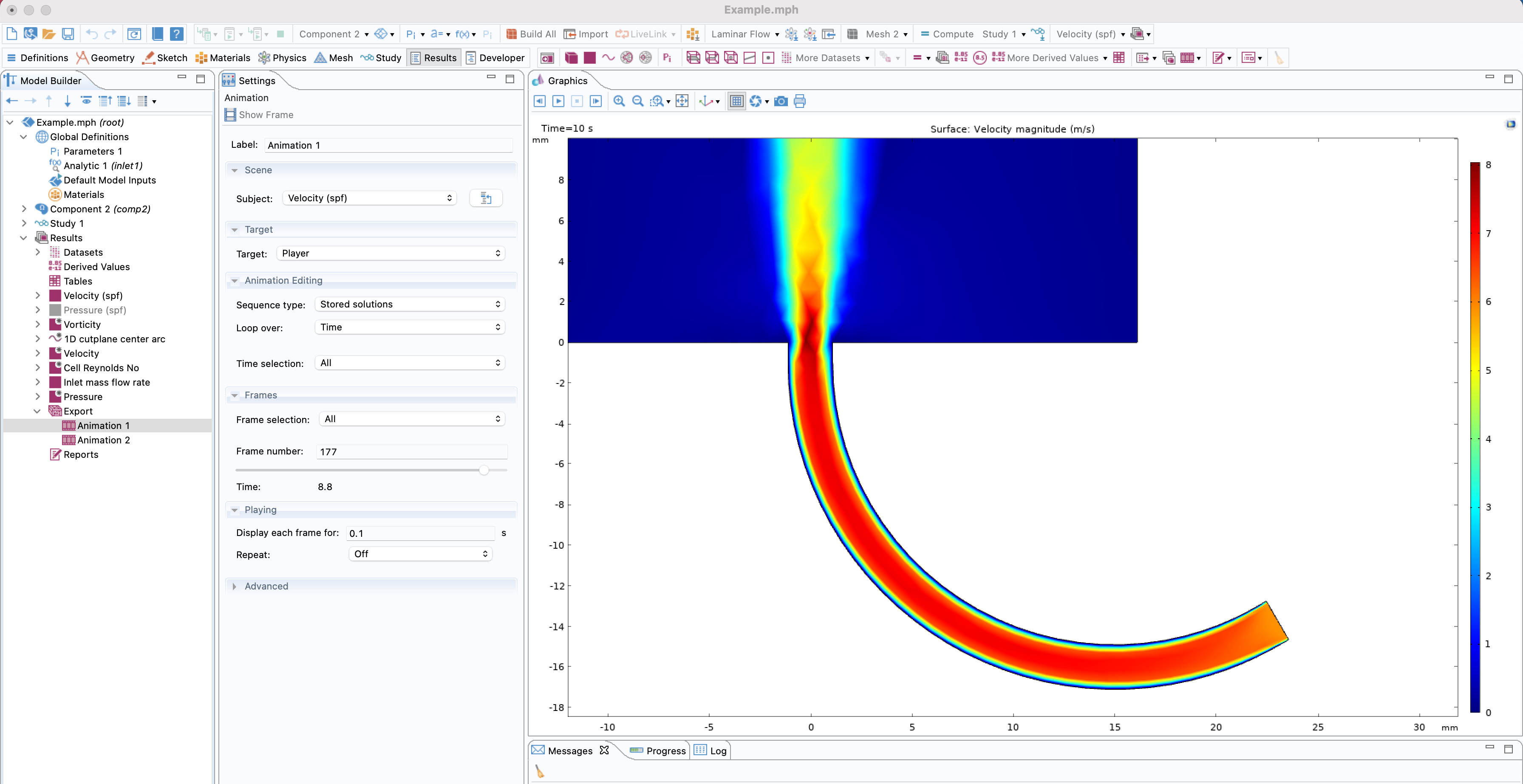

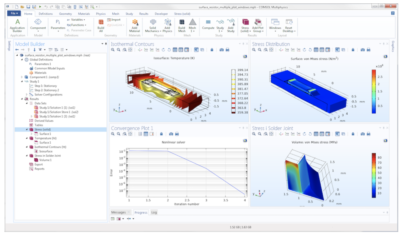

I've used the deformation subnode for showing delfections before. But, I think my question is a little different or I am not clearly understanding what you said. Essentially what I am trying to get is shown in a screenshot from one of COMSOL's blogs (https://uk.comsol.com/blogs/how-to-customize-the-comsol-desktop-and-use-keyboard-shortcuts/), but for a regular 2D plot as well as an animation. I created an example case where I tried doing as suggested in the blog for an animation, but not sure how to do that. For still plots, is dragging windows (as in the blog) the best side-by-side comparison we can do?
