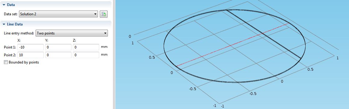

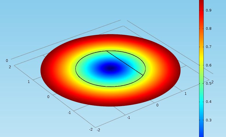

I have a 3D structure (thin disc) which I stretch and then apply a surface load to it. Originally the disc is 2mm diameter, but after I stretch it, it becomes 4mm diameter.
Once my simulation runs, I then create a "Cut Line 3D" which is a line passing through the diameter of the disc. Which is Image 1 below. As you can see the line passes from -1 to +1, but is created long enough to take into account the new stretched size of the disc.

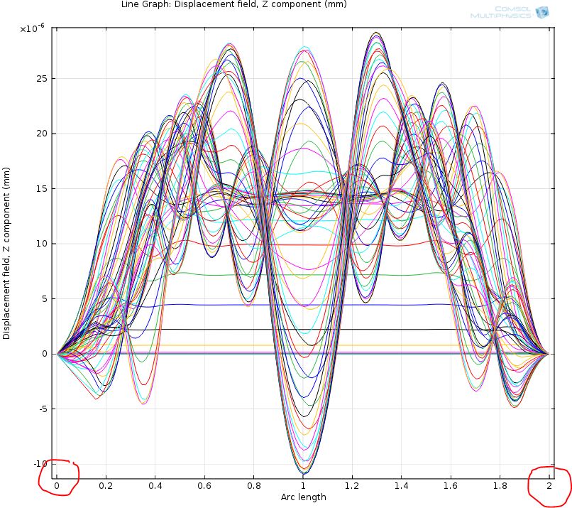

However when I plot a Line plot of the displacement of the membrane using "Cut Line 3D" the Arc length is only 2mm, as seen in Image 2.
Which is wrong as the disc has been stretched. Which is image 3.
Does anyone know whats going on here? I am almost pulling my heir out!!

have you tried to plot it with the expression for the x-axis as "x" (and then later X) ? (or Y if appropriate)
this will most probably give you different results, I assume the arc length is referrred to the material frame (before deformations)

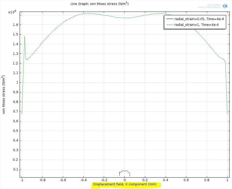

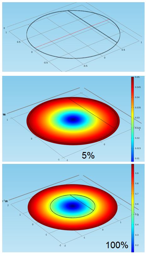

Again, I have the membrane and I stretch it by a percentage of its original radius. I have 2 different stretch factors.
- 0.05% and 100% [for illustration purposes more than anything]
For both of these, the membrane is stretched past its original shape. As shown in Image 1. So I know that the model is being stretched, but am having difficulties extracting stress values.
Then, when I wish to plot the Mises stress through the middle of the membrane, shown in Image 1. And I plot them, I get the problem shown in Image 2 (the x-axis shows that the deformation is not 5% and 100%).
The diameter of the membrane is 2mm, so I would expect the x-axis "Displacement field" to be -2mm +2mm for 100% stretch and -1.05mm +1.05mm for the 5% stretch.

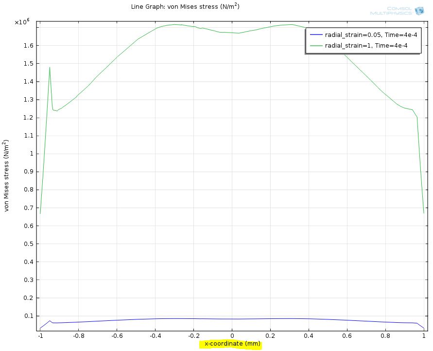

In figure 2, I have plotted 'u' in the x axis, as the expression. Plotting x or X, is shown in Figure 3. Figure 3 is the most confusing for me as it shows the stress within the membrane but to me it looks like its suggesting that both membranes are the same size (which from figure 1 is obvious that they are not).
This is quite confusing. Any suggestions?

No no suggestions, but I tried a simple test for me the logic seems coherent but for such large deformation I use the "geometrical non linearity" solver setting (nece my x=X+u)
