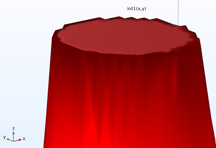

Hi Jeff,
First of all, thanks for your polite reply and advice.
I don't have to stick with exporting and importing height expression to another model method. I would appreciate any faster and more precise alternative method.
Upon your recommendation, I reviewed the Deformed Mesh and Deformed Geometry features from Reference Manual.
I guess Deformed Geometry fits my problem best since the excessive material will be removed from the control volume.
However, I could not solve the 2D PDE that I have defined on only one surface of 3D geometry. Would you mind if you could suggest any topic in the Discussion Forum to help me understand deformed mesh interface.
