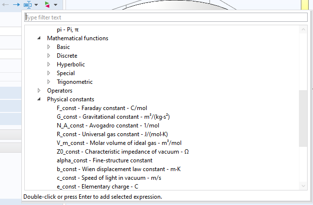

Yes, from the File menu, choose Help>Documentation (or press Ctrl+F1) to get access to the entire COMSOL documenation set. Search for physical constants, for example, to find the information you need.
During postprocessing, in text fields for expressions, press Ctrl+space to open a window where you can choose from all relevant constants, functions, and variables and insert them in the expression to plot or evaluate (see the attached screenshot).

Hi Magnus,
Awesome! your help is much appreciated. This is what I was looking for.
The attachment also helped. I use that to find the equations. The ctrl+space takes me to the unit system window. (I am on windows)
