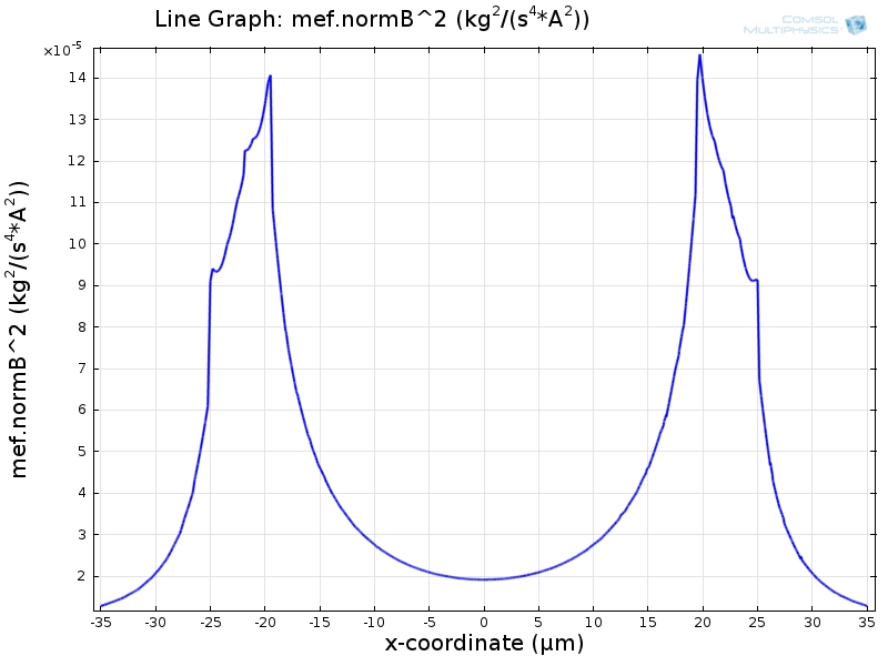

I am a new user to COMSOL, and I have been trying to model a wire loop made of copper with current running through it. I have to wires that make a small loop and I was hoping (and expected) to see the magnitude of the B-Field greatest in the center of the loop. However, what COMSOL shows is a B-Field greatest at the wire. Unfortunately as well, when I try to plot a graph of the field across the wire loop I am unable to get a smooth graph (picture attached), which means I can't take the gradient of the field to try and calculate the force.

4. Jpeg of graph produced from taking "slice" of data across the x-axis showing the two "sharp" points
