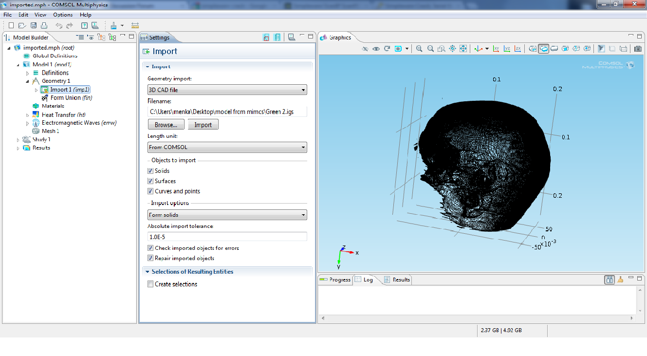

with the help of mimics software 10.1.1,created a 3d geometery of human head using mri data of 206 slices.im trying to export that 3d geonmetery iges file.but im importing the file into comsol ,it is showning the polyline,but after exporting.whethere a lots of option for exporting the file like .stl,.vrml,.dxf.etc. i have tried to export in form of .stl file.but during importing into comsol.it is showing and error that face cannot be parametized. if you have time,i request you to see the attach file which is a snapshot of comsol.

From your picture you attached, I could see a lot of small objects isolated from the main head. This is very bad. You won't be able to mesh it in the future. You have to clean the small patches using Mimics or other softwares. You can google the key word to find the simpleware. I think you can download a trial version. Your current MIMICS version is pretty old. I suggest that you'd better to use higher version which far more powerful to compete your goals.
