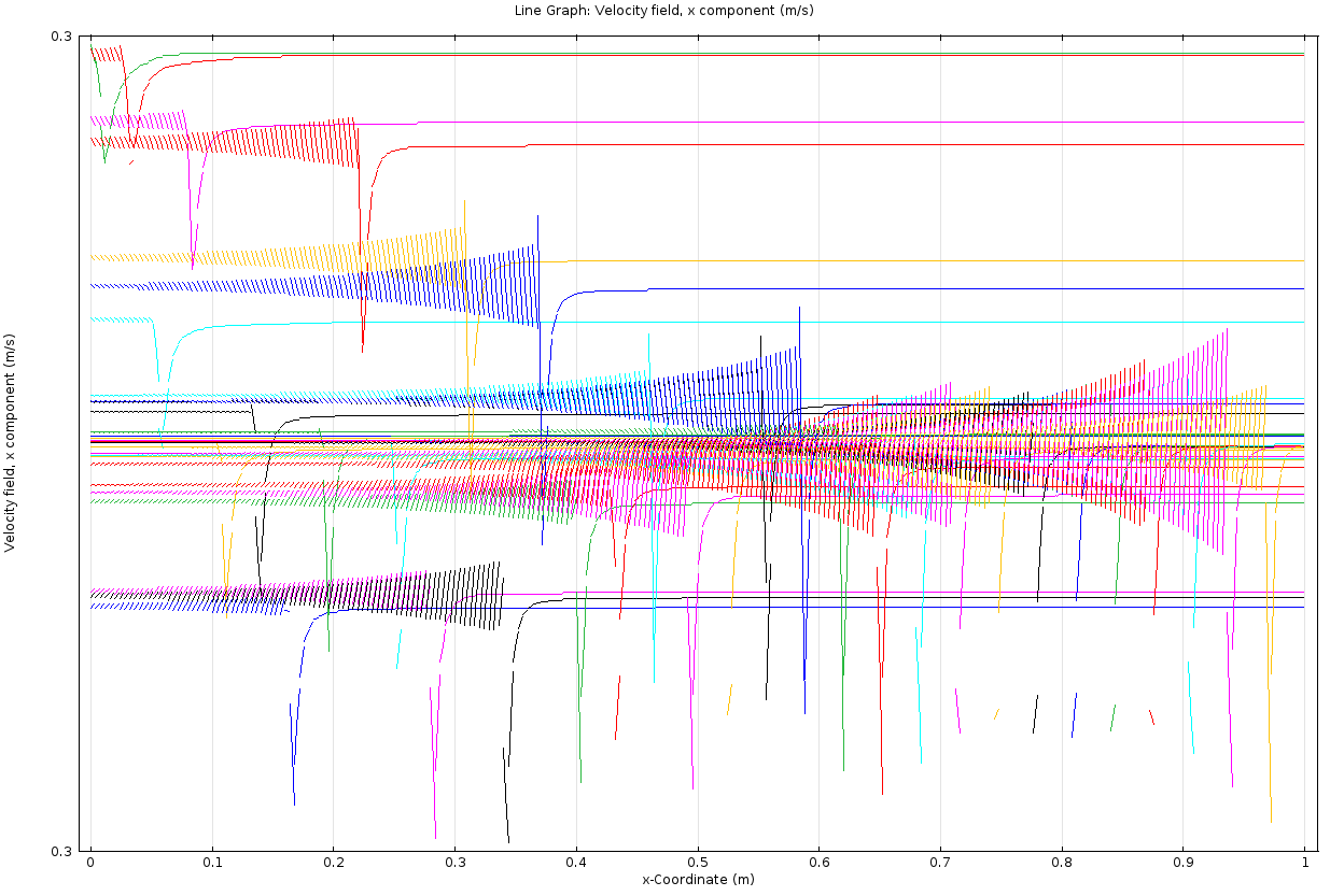

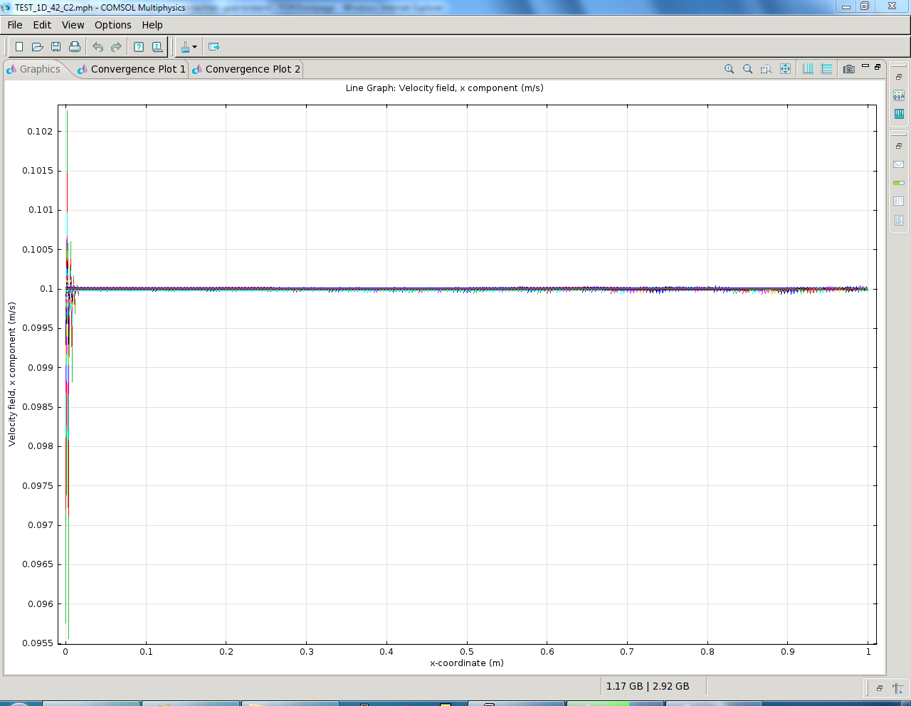

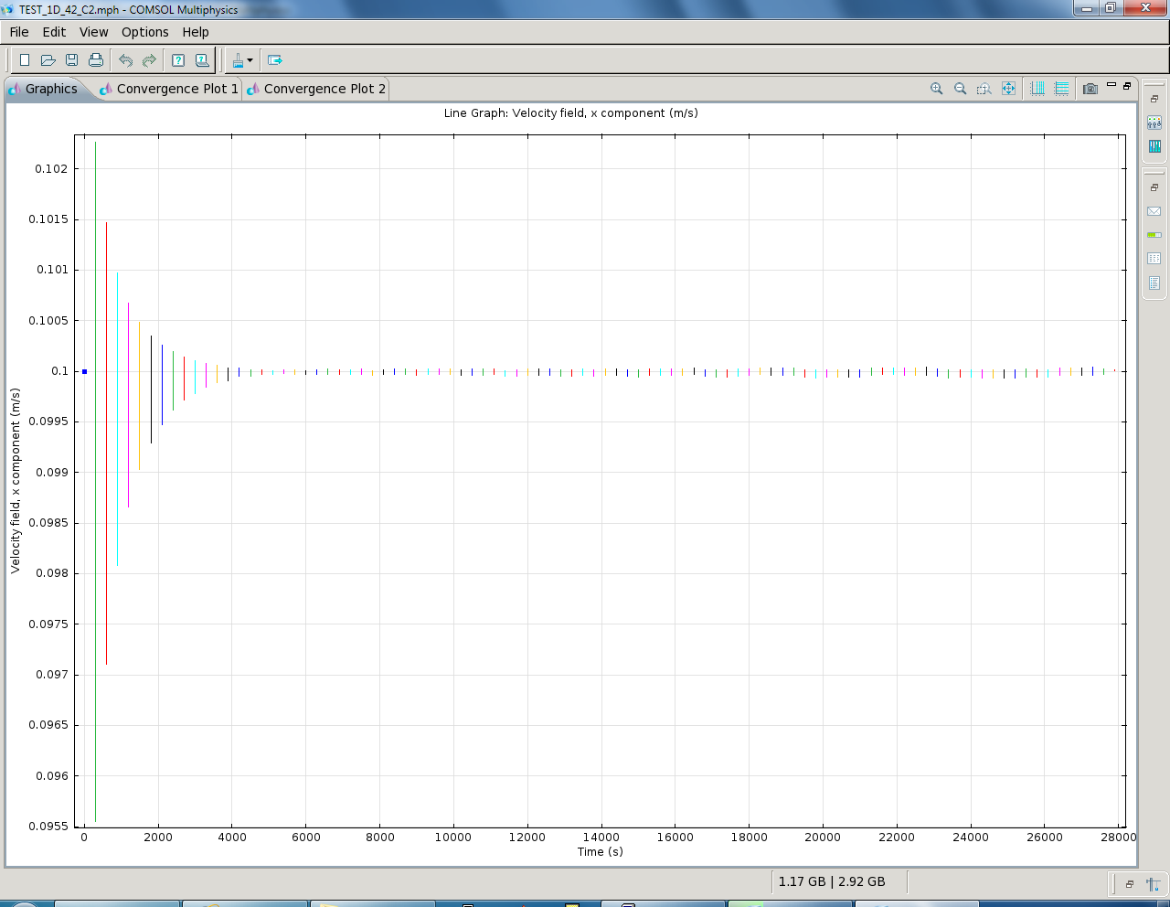

A small question this time: Does anyone know how to remove the crazy (!) oscillations that occur in my velocity profiles (and all other graphs dependent on the velocity) ?
I am using 1D Darcy, Transport of species in porous media and 2 heat transfer modules. Changing solvers, timesteps, boundary conditions and number and type of elements has no effect. If I take the gas viscosity (mu) constant instead of using a (linear, temperature dependent) function, it is less bad, but still there.
So, any ideas? (please view attached picture to see what I mean ;) )
Thank you so much for your time.

You're right to not trust the results, if I got a result like that I wouldn't trust it either.
Without seeing your model I can't say much about it, I also don't have experience with the kind of simulations you're doing.
Maybe you need to refine your mesh?
Check the convergence plots as well, see if you see something weird.
I would suggest to do a very basic simple simulation and see if you can reproduce the artifacts.

Thank you all for you comments, in particular Ivar for his extended explanation.
I have read the reference guide (again :P ) and I think I found the source of the problems (which I indeed to a certain degree managed to repeat in a simple model). The problem is that when the Peclet number is greater than 1, you are bound to get numerical instability. On page 354 of the reference guide a measure for instability is given:
Pe= (||v|| * h ) / (2 * c)
v is the convective velocity vector, h is the element size, c is the diffusion coefficient.
When Pe is greater than 1, and you have certain boundary conditions, you get instability.
Fortunately, they give the solution in terms of adding numerical diffusion which you can control under the 'stability' tab of many modules.
Unfortunately, such a tab is nonexistent in the Darcy flow module, the one that I am using of course, so,...I still don't really know how to get rid of this annoying instability.
They proposed to use more elements but it (my real simulation) is already slow with 250 elements, so using 1000's of elements is unworkable and I strongly suspect (based on testsimulations) that this will not work anyway.
My question to you all now is: any other ideas on how to solve this? And why isn't there any option for stabilization in Darcy / Transport of species in porous media ?

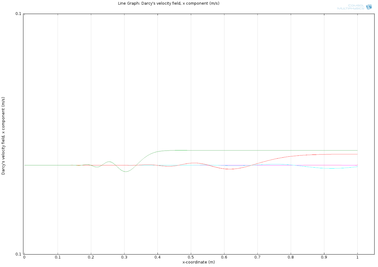

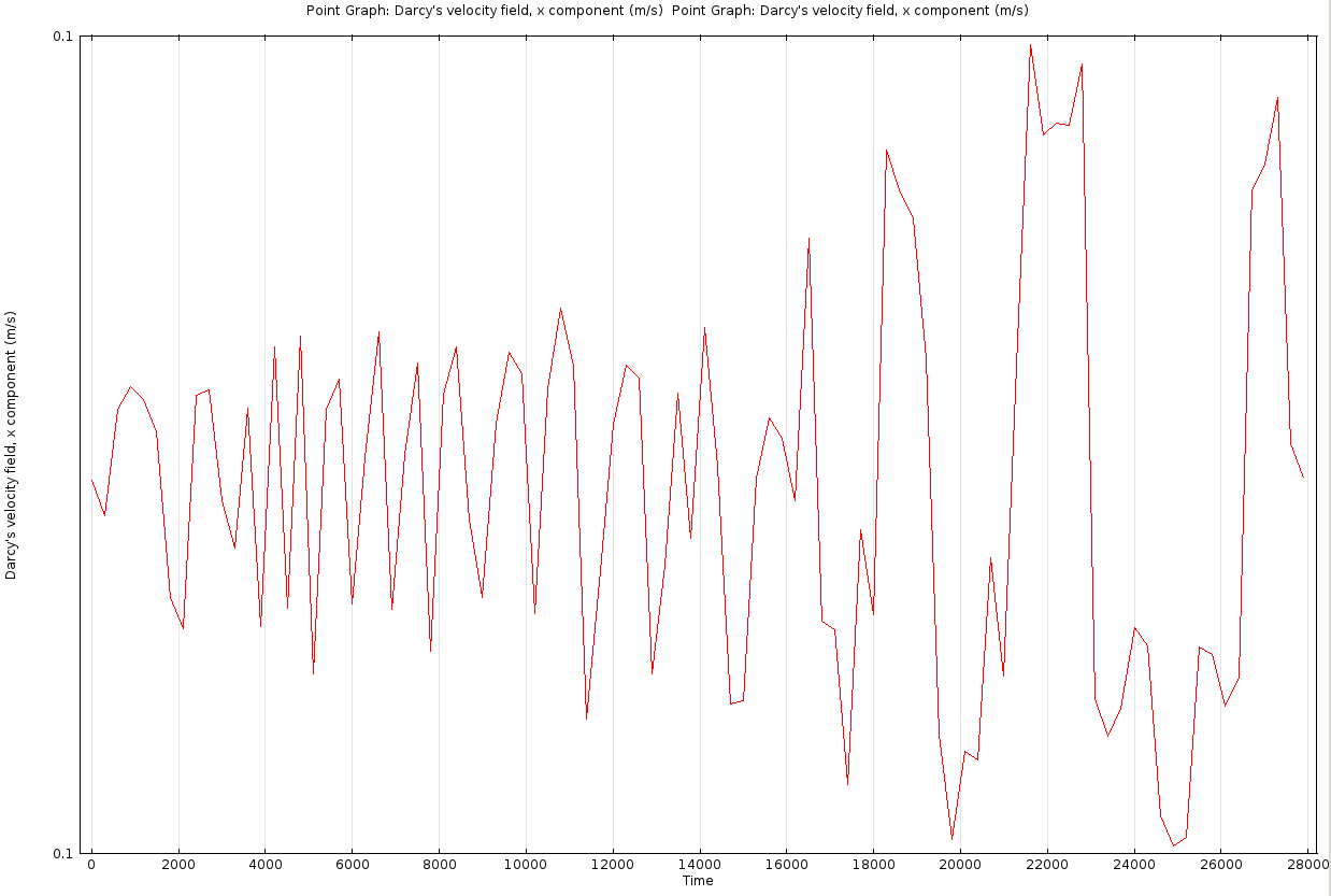

Please view the attached pictures and/or the corresponding attached models if you want to see it in actual action.
The first model is a very simplified model which does seem to show the same behaviour.
The second model is a stripped down version (to make it a lot faster to solve) of my actual model, which shows this behaviour very strongly.

This is a very interesting problem and discussion. As mentioned, the instability identified via the Péclet number occurs when the convection term is higher than diffusive term in an element. The velocity term in Darcy’s equation is not a convective term, so it’s not that. However, there is certainly a convective term in the “Species Transport in Porous Media” physics. That could indeed be the source of the oscillations. However, there are some factors that, to me, indicate that the cause could be something else, at least for the simpler model that you posted.
This type of convection/diffusion instability, usually occurs both for transient and steady state, and it goes away if you sufficiently refine the mesh. In your simple model refining the mesh does not help, and the oscillations nearly disappear after some time so they could be caused by a sudden change in loading in a transient analysis. If you try ramping up the C0,c2 inflow condition in the Species Transport and also the velocity condition in Darcy’s Laws with a fast acting step function, the solution becomes less oscillatory. I don’t know how much of that applies to your other detailed model. One more factor to investigate!

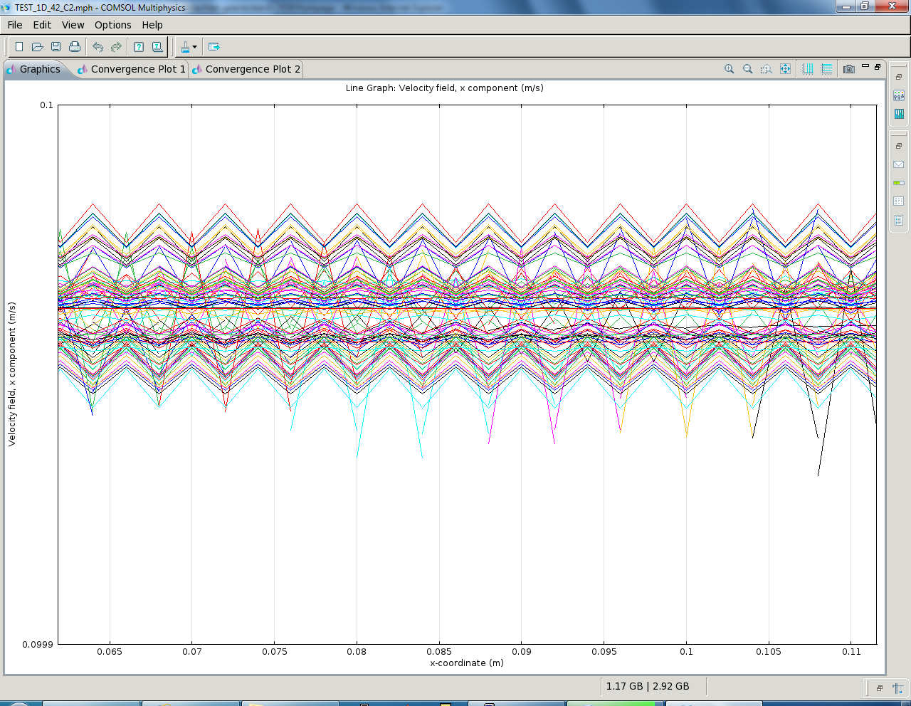

Please keep us posted if you resolve the issue.
Dear Nagi,
Thank you for your input.
It seems you are right. I did more tests and must conclude that apparently the high Peclet number does not seem to be the problem in this particular case. I now used a stepfunction to increase the inflow velocity from 0 to v_in and this did indeed resolve the issue with the oscillations in the v plots.
However, I now noticed that the plot for the velocity is just a horizontal line (the v_in that I used as input), which means that apparently the inflow of mass (my drying reaction, input of H2O in gas stream) does not have any impact at all on the velocity. I dearly hope I did not miss anything fundamental or something, but it looks to me as if the increase in concentration/density does not reflect a change in pressure/velocity in this case, which seems wrong to me. Maybe the definitions of pressure in COMSOL are confusing me again.

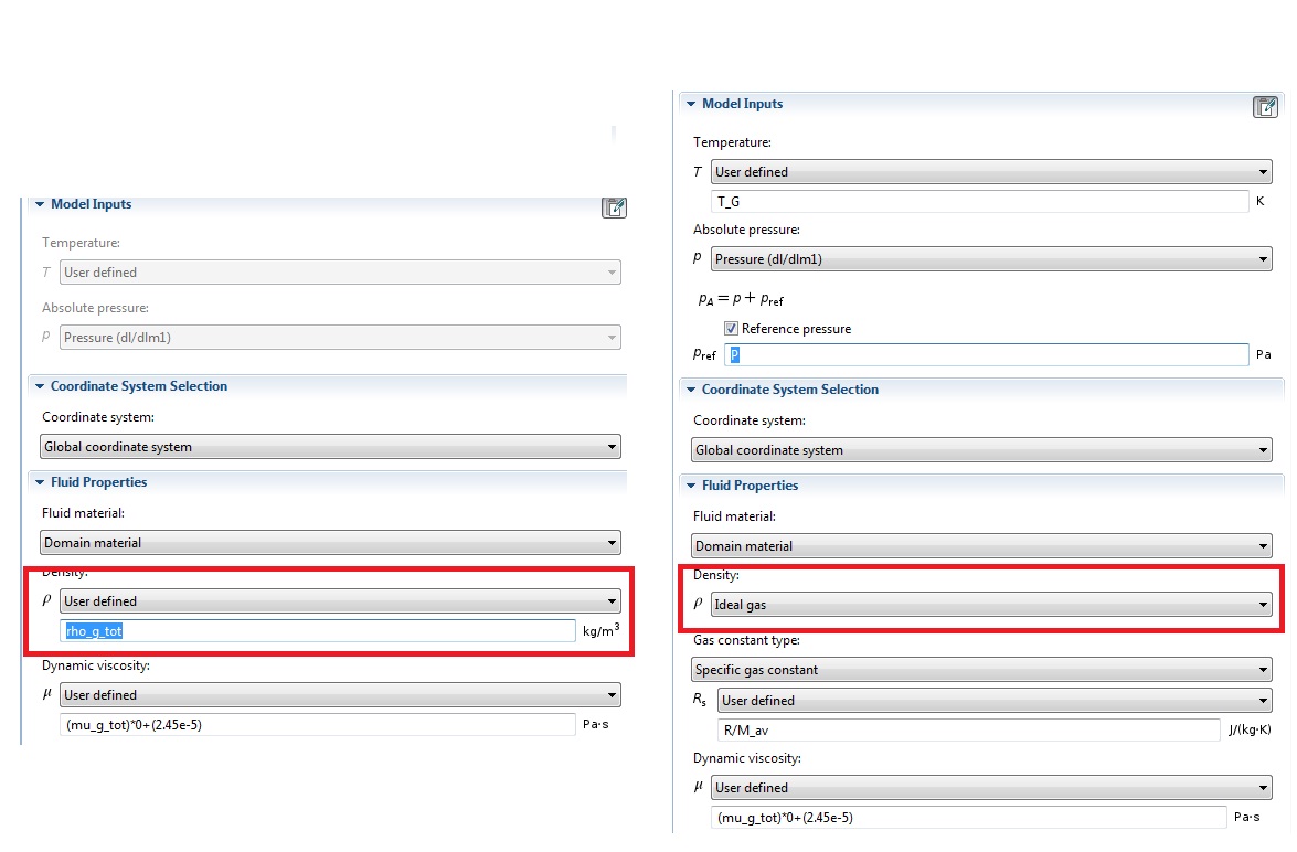

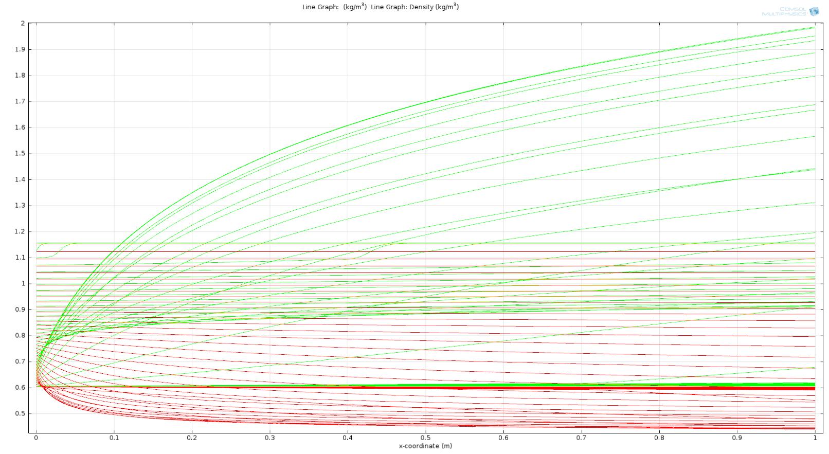

If I set Darcy density to 'self defined' rho using rho_total=SUM[rho_i] I can't set the pressure and temperature. But if I set the density to 'Ideal Gas', I get the P and T option.
(see Darcy_Interface_self_defined_rho_vs_Ideal_Gas.jpg).
This leads to very different results.
(see rho_g_tot_vs_x.jpg, rho_g_tot is green, dl.rho is red).
Why is that different, according to (rewritten) Ideal Gas Law, rho_i=Ci*Mi, right?
So why the difference? How then does Darcy calculate the density? I have checked the manuals but can't find what I am looking for.
For the velocity this means that with the self defined rho, v=0.1 constantly, while with the Ideal Gas option, the velocity goes up to 2 m/s.
This could be right, but I have no idea to check if it is. Any help would again be greatly appreciated. Many thanks for reading.

3. Regarding the difference between the ideal gas density calculated by Darcy's module and the density calculated manually by rho = sum(c_i*M_i) --> been there, done that! And I had weird results just like you. This is when we began to realize that solving the N species equations + the continuity equation made the problem overdefined.
In a way, you just proved it yourself: you used the sum of your species concentrations to calculate the gas density. From this density, you know that you can calculate the pressure with the ideal gas law. Now that you have the pressure, you just have to calculate the Darcy's velocity in a list a variable. The Darcy's velocity calculation is very simple, it's the same calculation as, for example, the heat flux that Comsol calculates when you plot a heat flux (q" = -k*d(T,x). You don't need a module to do that for you, and remember that the Darcy's module solves a form of the continuity equation, expressed with the pressure as the dependent variable, then it calculates the Darcy's velocity separately from the pressure.
An excellent reference regarding the sum of the N species equations is: Transport Phenomena 2nd Ed. by Bird, Stewart and Lightfoot, section 19.1: The equations of continuity for a multicomponent mixture.

I played around the mesh size and timestep .Only the amount of oscillations changed and the results were not stable. I also changed flsmhs to triangle, rectangle, and flc1hs step functions and they didn't solve the problem, either. I am not sure how I should change size of transition zone or scale for the step functions.
Lastly, I used time discrete solver and it returned better results than time dependent solver. Is it right to use time discrete solver in my case? I didn't use any bdf or prev operator anywhere in my model.
I forgot to mention that reference guide lists some stabilization techniques for this kind of problem but even though I choose stabilization option under the show menu, I can't see them in my module. Are they not available in pde module or is it something specific to the version I'm using (version 4.2 with classkit licence)?
Thank you very much.
nihat
Hi Ivar, I have access to Comsol via remote desktop application and it was crashing from time to time but I guessed that was normal. I don't know why it's doing the same thing to you. Sorry about that. I played around the mesh size and timestep .Only the amount of oscillations changed and the results were not stable. I also changed flsmhs to triangle, rectangle, and flc1hs step functions and they didn't solve the problem, either. I am not sure how I should change size of transition zone or scale for the step functions. Lastly, I used time discrete solver and it returned better results than time dependent solver. Is it right to use time discrete solver in my case? I didn't use any bdf or prev operator anywhere in my model. I forgot to mention that reference guide lists some stabilization techniques for this kind of problem but even though I choose stabilization option under the show menu, I can't see them in my module. Are they not available in pde module or is it something specific to the version I'm using (version 4.2 with classkit licence)? Thank you very much. nihat
Posted: 1 decade ago 17 avr. 2012, 10:02 UTC−4
I would try out the change the step function to have a smoth transition and then steepen it to get closer to your initial step function (open up all tabs there you will see the step function transition time field)
There are a quite some discussion on stabilisation techniques around in the doc. I'm not that familiar with your type of imulations, and as I can get it runningI cant really say much more, but there are others out here with more experience in this field than me ;)
Hi I would try out the change the step function to have a smoth transition and then steepen it to get closer to your initial step function (open up all tabs there you will see the step function transition time field) There are a quite some discussion on stabilisation techniques around in the doc. I'm not that familiar with your type of imulations, and as I can get it runningI cant really say much more, but there are others out here with more experience in this field than me ;) -- Good luck Ivar
Posted: 1 decade ago 17 avr. 2012, 10:14 UTC−4
Hi Nihat,
The time discrete solver is a good solver to use for transient problems even if you don’t use the prev or bdf operators.
