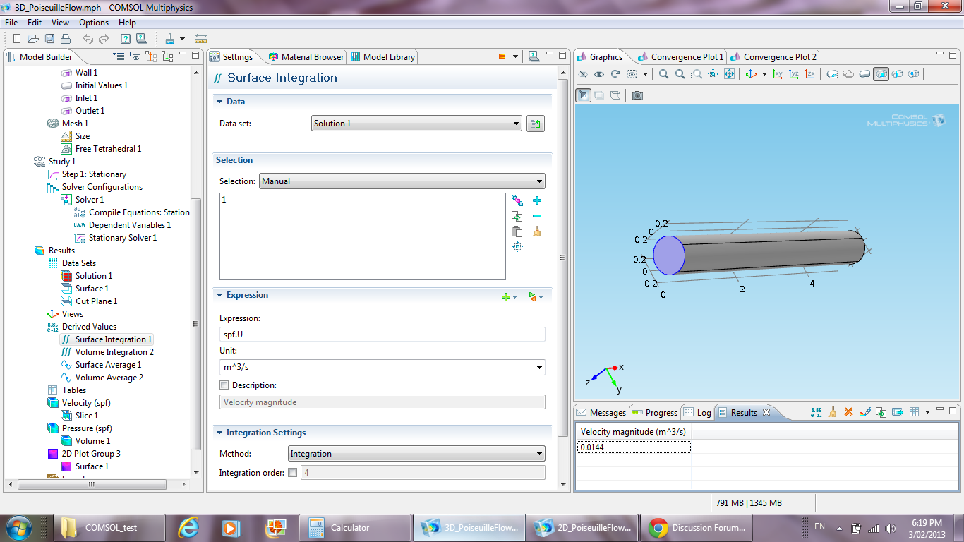

Posted: 1 decade ago 3 févr. 2013, 02:21 UTC−5
Dear Jaap,
I tried to reproduce what you did to get an idea of how COMSOL calculates flow rate. However, I am also getting two different flow rates from analytical and simulation (nearly 22 unit difference). I went through the recommendations but still could not figure it out where the problem is. Would you please have a look at the snapshot of my model attached and advise me on that?
Analytical flow rate (Poiseuille flow): 0.32 m^3/s
Numerical (COMSOL) : 0.0144 m^3/s -------> using surface integration
I am using v42 and could not find the "compute surface integral" under the Integral setting as Nagi recommended for 2D.
Dear Jaap, I tried to reproduce what you did to get an idea of how COMSOL calculates flow rate. However, I am also getting two different flow rates from analytical and simulation (nearly 22 unit difference). I went through the recommendations but still could not figure it out where the problem is. Would you please have a look at the snapshot of my model attached and advise me on that? Analytical flow rate (Poiseuille flow): 0.32 m^3/s Numerical (COMSOL) : 0.0144 m^3/s -------> using surface integration I am using v42 and could not find the "compute surface integral" under the Integral setting as Nagi recommended for 2D. Best regards,
Posted: 1 decade ago 3 févr. 2013, 04:57 UTC−5
I do not see why it should not give as the anlyitcal results, for me it has always matched, within 10-20%often far better depending on meshing and on model
the 2*pi*r multiplier applies onlyy to 2D-Axi, the option is in one of the Definition Model coupling Integration node sub-tab, closed by default. But you can also easily add the 2*pi*r by hand, so long you do not both, you see the error in case in the units
In 3D a direct integration over the bondary should work, provided the mesh is fine enough to correctly resolve the velocity along the tue axis, and the parabolic profile across the boundary

Posted: 1 decade ago 5 févr. 2013, 08:58 UTC−5
It is not uncommon when you have a coarse mesh through the cross-section to get a flow rate that is much smaller than the correct value.
Nagi Elabbasi
Veryst Engineering
It is not uncommon when you have a coarse mesh through the cross-section to get a flow rate that is much smaller than the correct value. Nagi Elabbasi Veryst Engineering
Saeid Norouzi Apourvari
Posted: 1 decade ago 5 févr. 2013, 19:28 UTC−5
Dear Ivar and Nagi,
Thank you so much for your help,
That's right, my mesh is quite coarse on the boundary where I compute the surface integration.
I was thinking that I should get better result (for the same mesh quality) when I am using volume intergration or volume averaging instead of surface integration but still not that much difference!
saeid
Dear Ivar and Nagi, Thank you so much for your help, That's right, my mesh is quite coarse on the boundary where I compute the surface integration. I was thinking that I should get better result (for the same mesh quality) when I am using volume intergration or volume averaging instead of surface integration but still not that much difference! Regards, saeid

Posted: 1 decade ago 7 févr. 2013, 08:16 UTC−5
Wow, what a mistake! my mesh was soooo big.
Multiplying the radius and the length by 10^-6 gives the same result as analytical method.
Thanks Nagi,
saeid
Wow, what a mistake! my mesh was soooo big. Multiplying the radius and the length by 10^-6 gives the same result as analytical method. Thanks Nagi, Regards, saeid
