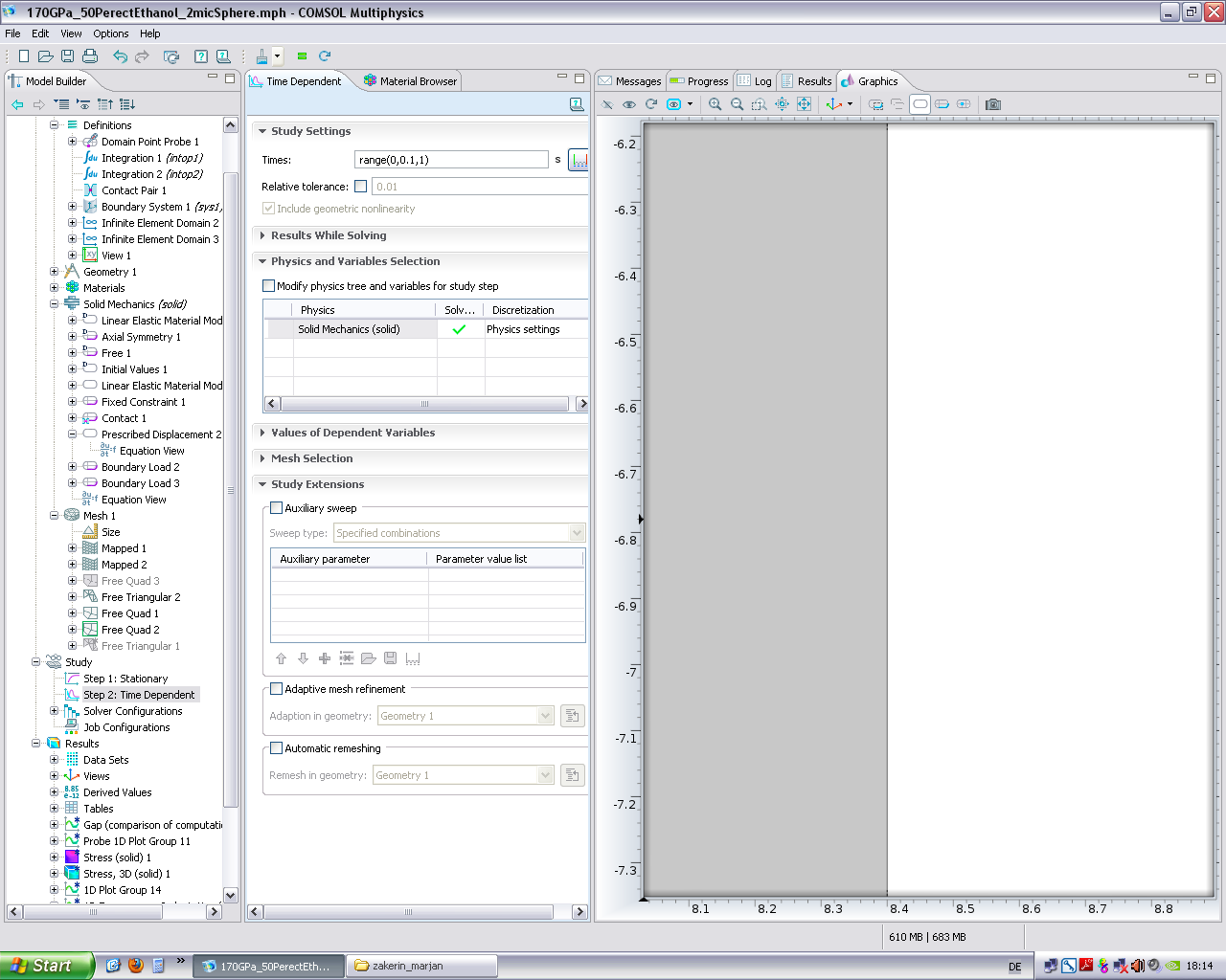

I'm simulating contact between tip and sample, but it is difficult to converge doing time dependent study. I use small time step and the discretization of displacement is larger than contact. As there is no inertial contact, the inertial pressure should be zero right? More over, have you met the 'warning: New force constraints node detected' when tip indents the sample? I appreciate if you could give me some advice. Thanks a lot.
Wenqi Deng
What are you using for your time dependent tip movement control? Parametric sweep or continuation. I would say that you would better use continuation.

The tip movement is controlled by a sinusoidal force(which depends on time variable 't'), it should be the contiuation you mentioned?
The sample elastic modulus is 3e9[Pa] (PPMA). Both the tip and sample are defined as linear elastic model. I define tip surface and sample surface as contact pair and use tetrahedral mesh(whose minimum element size is 1[nm]). And bottom of the sample is fixed.

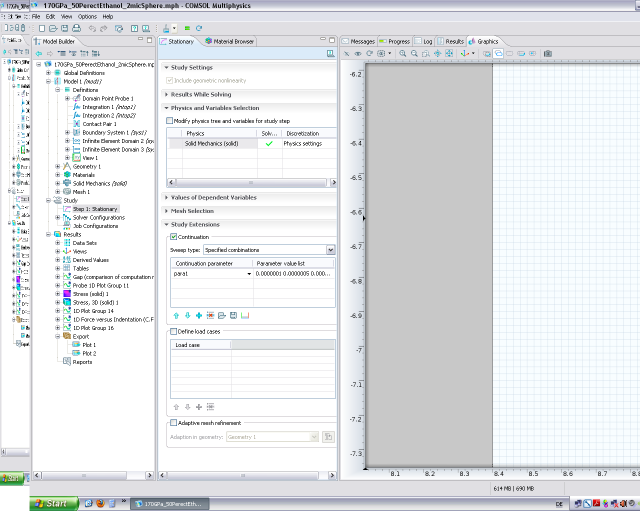

You can give values to " t" in continuation of parametric sweep. Use continuation. Please see the attached file. The second point is check that size of your mesh elements on the PMMA is 1.5 times smaller than the mesh size of your sphere. Check 2 times as well.
For penalty factor you should not have problem if you set the initial pressure about 1000 Pa or even larger.
