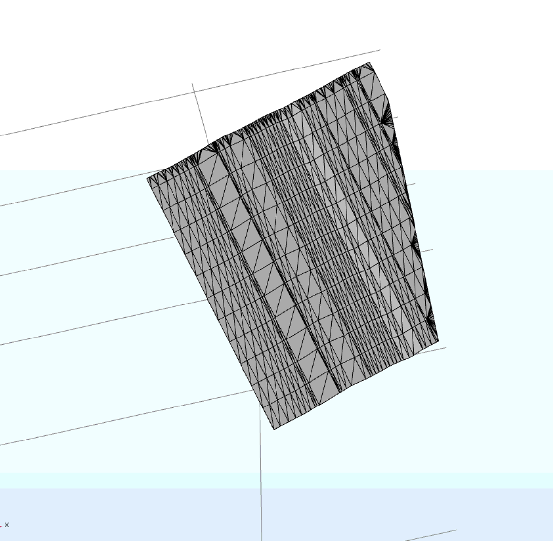

1) I tried to include faults with a .dxf file and the fault geometry is nicely imported, however it seems to be weirdly compartmentalized and rather too complex (see picture). I am not able to merge this geometry into one surface.

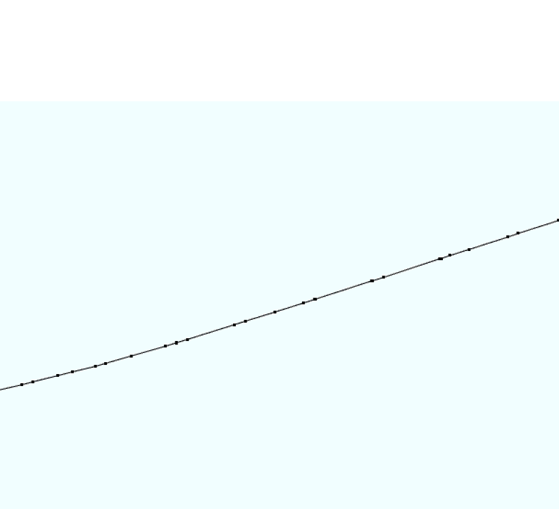

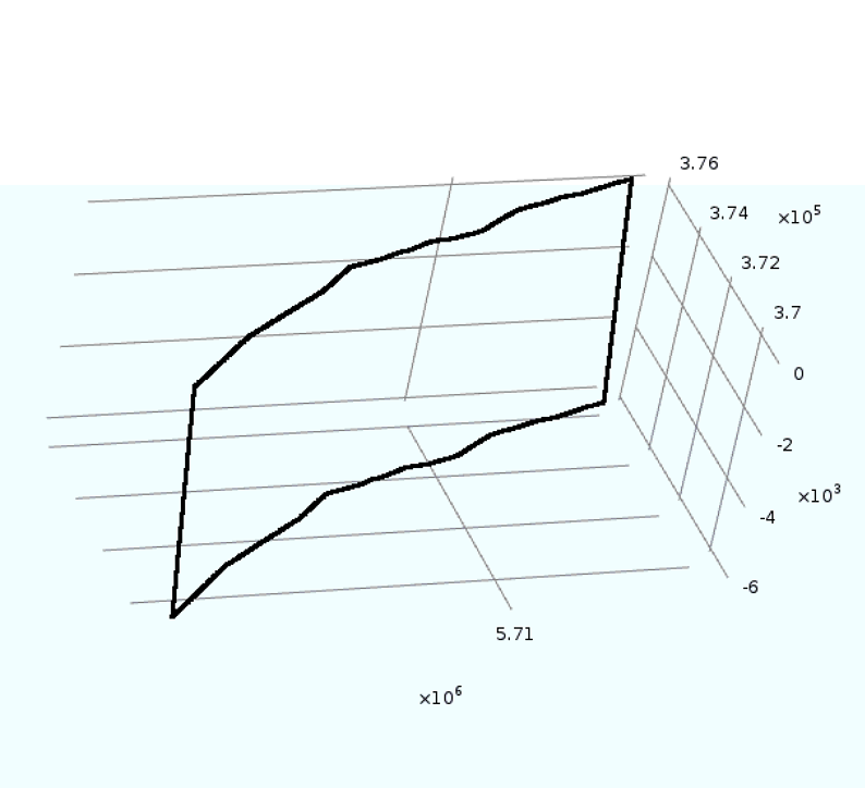

2) I tried to import it as a polygon (just using the boundary lines of the fault) with a closed curve. Polygons are nicely imported, however i am unable to create solid or surface out of it (i get a message that output object is empty) (see picture).

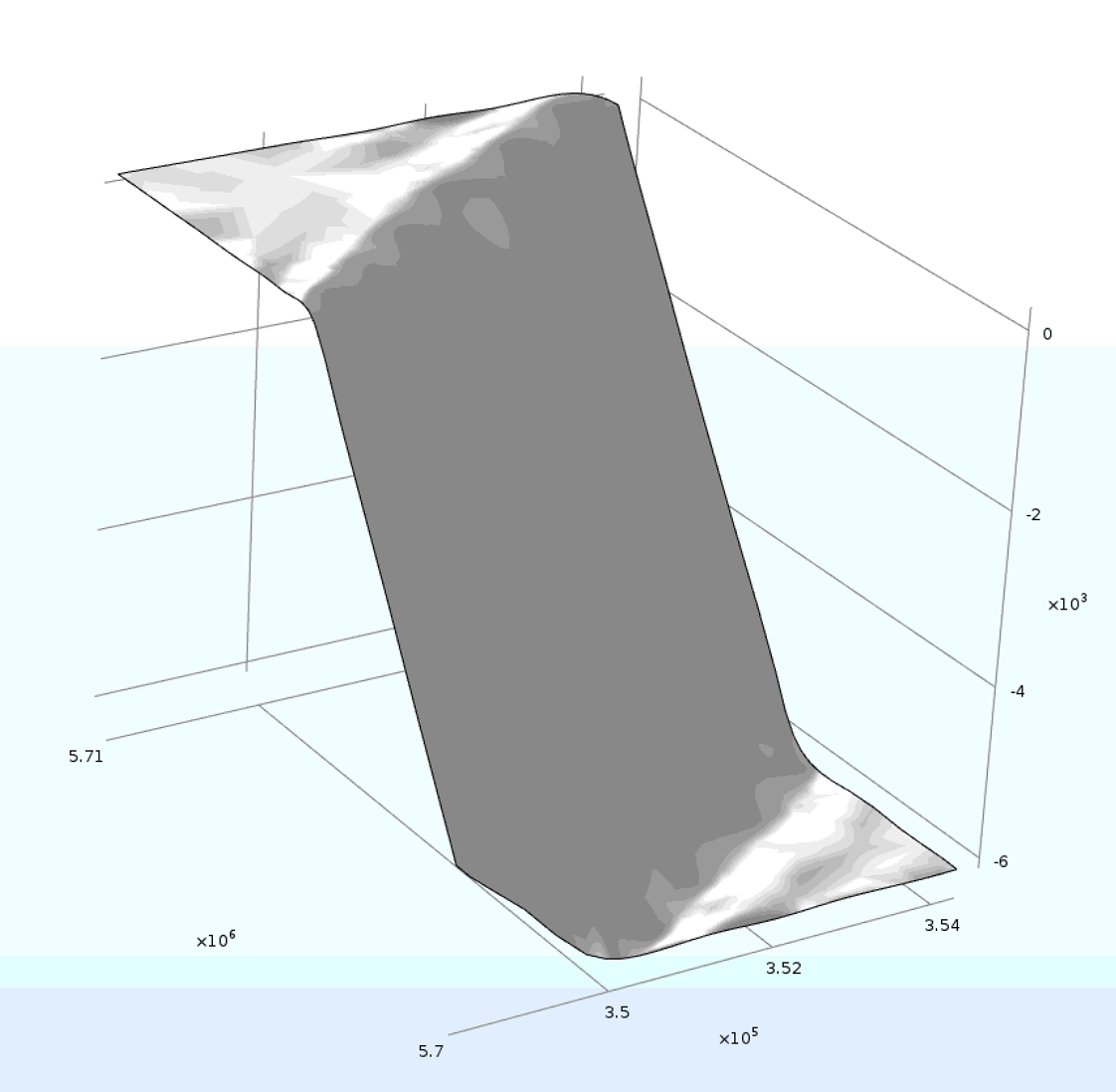

3) I tried to import it using the interpolation function. It seems to import well the geometry, but as the geometry is pretty complex, i am left out with weirdly quazi-horizontal planes on the top and the bottom of the fault (see pictures), which i cannot remove as the surface is not 100% flat.
