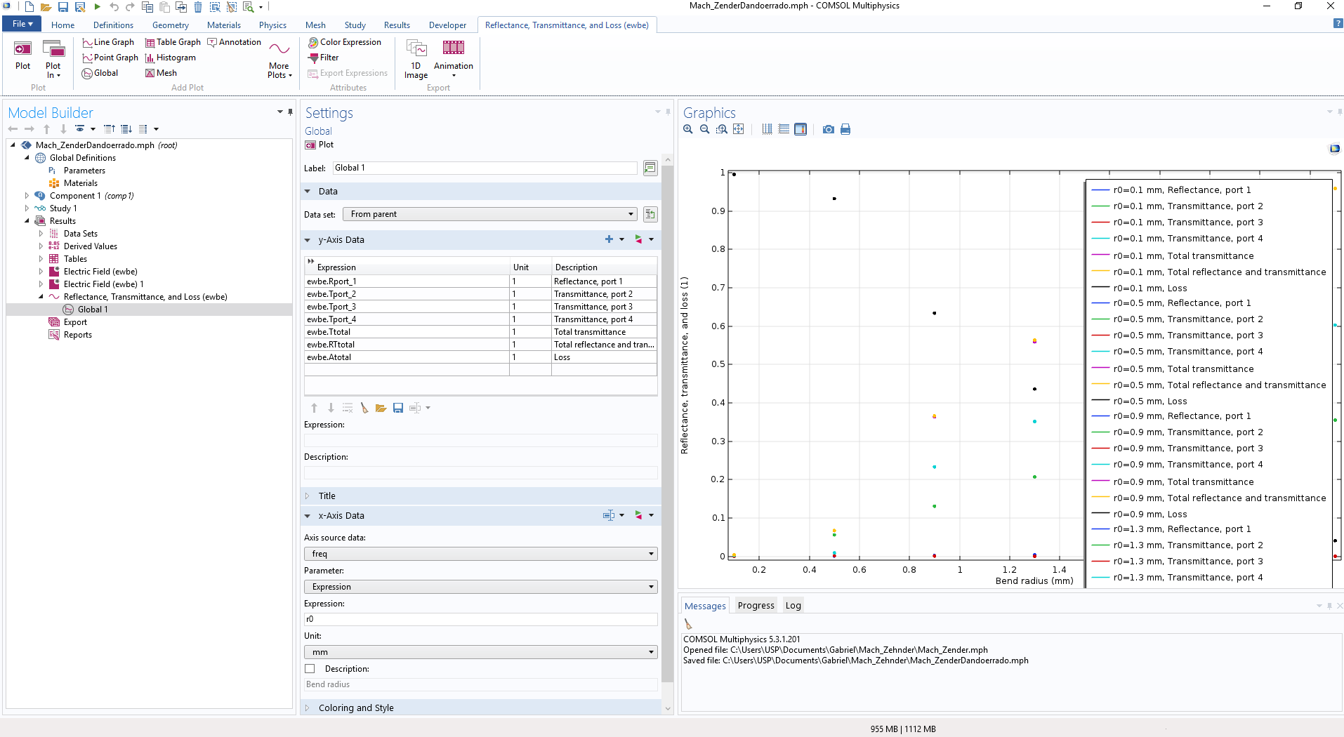

Hello! I'm having a little trouble following the Mach-Zehnder tutorial
https://br.comsol.com/model/mach-zehnder-modulator-15061
The graphic result was consistent until before Parametric Sweep The electric field I've obtained was consistent with the the result graph shown in the tutorial (page 19)
Following the next instructions, I was trying to obtain the graph shown in the Figure 2 of the tutorial. Instead, I obtained what is in the attachment.
There are different results going from 0.1mm and increasing of 0.4mm. Besides, the points appear scattered, not forming the graphs shown in Figure 3. What can I have done wrong and how can I fix it?
