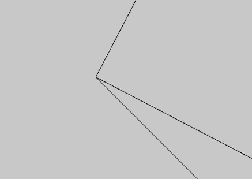

Is there anyway to create a fillet for a corner that connects three lines in COMSOL Multiphysics 5.3a for a 2D model?

take a look at the attached example. Build the geometry sequence step by step to see the idea. I am not sure if this is what you want. There may be other ways to achieve that.
Cheers Edgar
