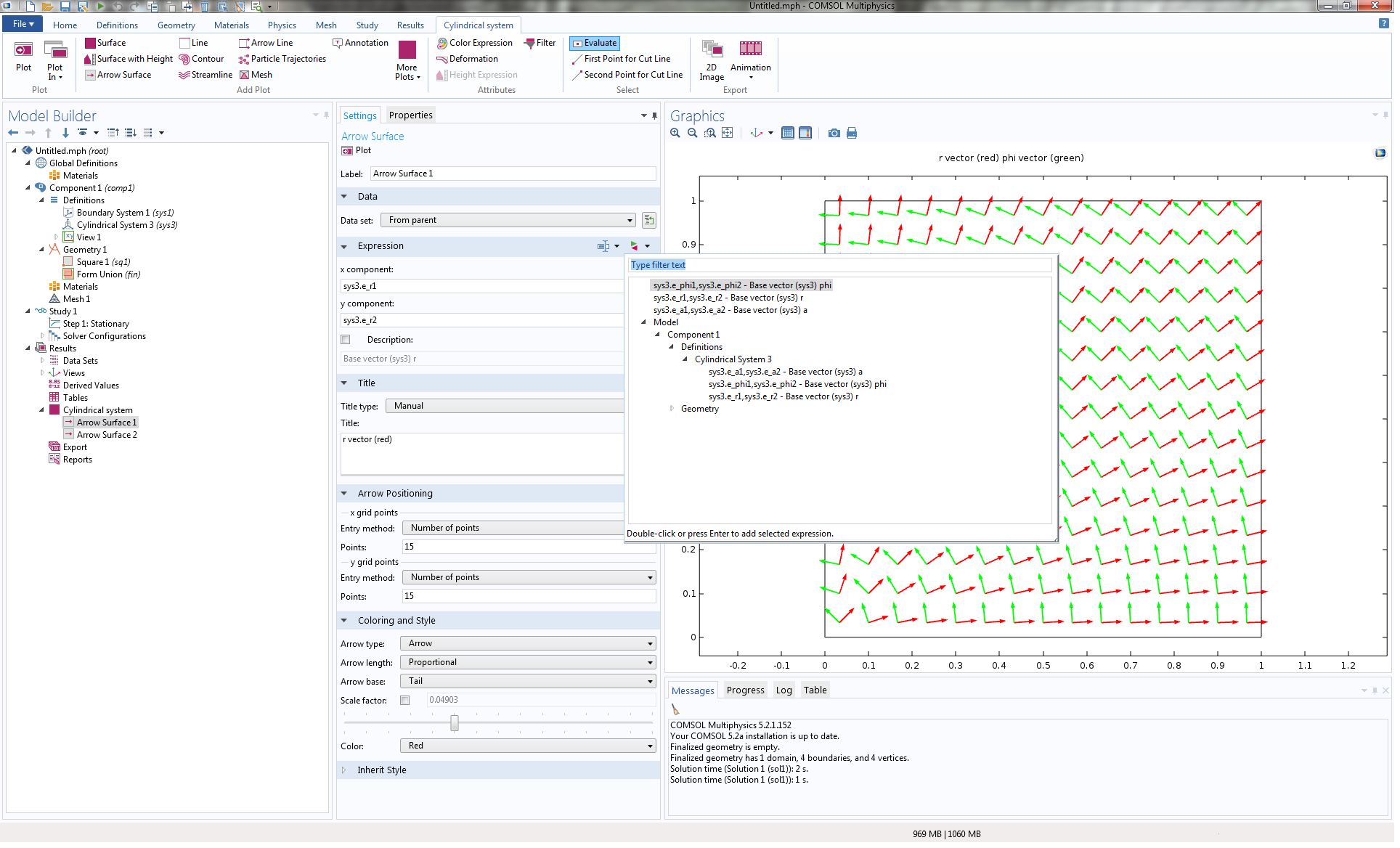

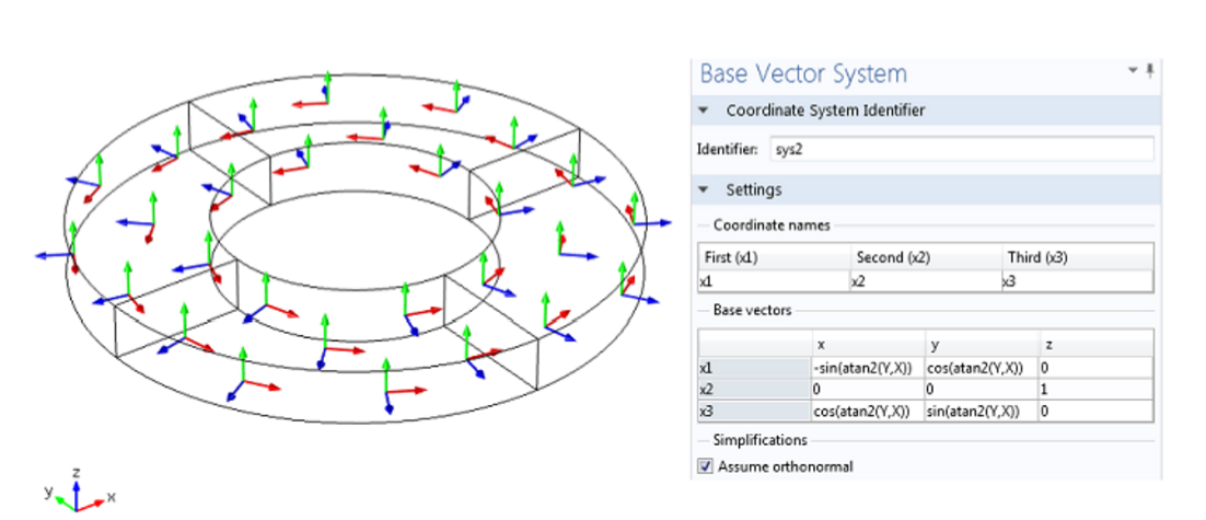

Yes, you can display the base vectors in your graphics by using arrow plots (2 Surface Arrow plots in 2D, 3 Volume Arrow plots in 3D). You can find the names of the base vectors by using the Replace Expression button, see attached screenshot.
Hello Jason, Yes, you can display the base vectors in your graphics by using arrow plots (2 Surface Arrow plots in 2D, 3 Volume Arrow plots in 3D). You can find the names of the base vectors by using the Replace Expression button, see attached screenshot. Best regards, Jeff
