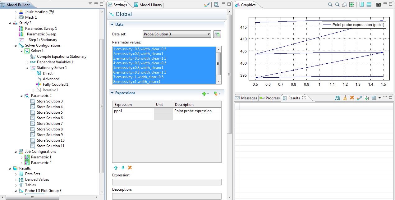

Posted: 1 decade ago 26 nov. 2010, 09:10 UTC−5
Thanks for your response.
I'm using 4.0a.
I could manage to get the desired plot, but not in a "comfortable" way: I am using different studies for one parameter (e.g. emissivity), which I have to change by hand. In these studies I make then a sweep for the second parameter ( e.g. beam length). As a result I get different solutions which I can combine in a plot group.
As the beam length should have a higer resolution than the emissivity (3 different values are ok), this approach is reasonable for me, but surely there must be a better way.
I guess you mean, I should do 2 parameter sweeps in one study?! I did, like shown in the attached screenshot. The sweep itself works, but if I want to plot, I can not select the results belonging to each parameter (e.g. emissivity). Just all results are plotted in the same plot.
Thanks for your response. I'm using 4.0a. I could manage to get the desired plot, but not in a "comfortable" way: I am using different studies for one parameter (e.g. emissivity), which I have to change by hand. In these studies I make then a sweep for the second parameter ( e.g. beam length). As a result I get different solutions which I can combine in a plot group. As the beam length should have a higer resolution than the emissivity (3 different values are ok), this approach is reasonable for me, but surely there must be a better way. I guess you mean, I should do 2 parameter sweeps in one study?! I did, like shown in the attached screenshot. The sweep itself works, but if I want to plot, I can not select the results belonging to each parameter (e.g. emissivity). Just all results are plotted in the same plot.

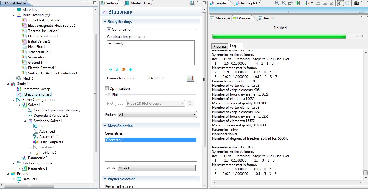

Posted: 1 decade ago 28 nov. 2010, 12:23 UTC−5
thanks for your help Ivar.
I understood and implemented your idea with an outer "parametric sweep" and an inner "continuation parameter sweep".
Unfortunately, a solution could not be found. The solver starts, but stops with this message:
Invalid property value.
- Property: solnum
'Solution' is an array of integers.
I tried all direct solvers with different tolerances (0.9 - 0.001) and also refined the mesh (minimum element quality now0.0083).
For a "manually sweep" on the other hand, with all the different combinations I could find a solution.
Any ideas?
Hello, thanks for your help Ivar. I understood and implemented your idea with an outer "parametric sweep" and an inner "continuation parameter sweep". Unfortunately, a solution could not be found. The solver starts, but stops with this message: Invalid property value. - Property: solnum 'Solution' is an array of integers. - : "" I tried all direct solvers with different tolerances (0.9 - 0.001) and also refined the mesh (minimum element quality now0.0083). For a "manually sweep" on the other hand, with all the different combinations I could find a solution. Any ideas?
