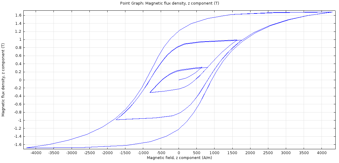

Posted: 1 decade ago 15 avr. 2014, 03:33 UTC−4
Hi Jens,
Thank you so much for your help!
It's still not perfect, but It basically works now :)
I attached the Hysteresis Curve I produced :)
Regards
Rook
