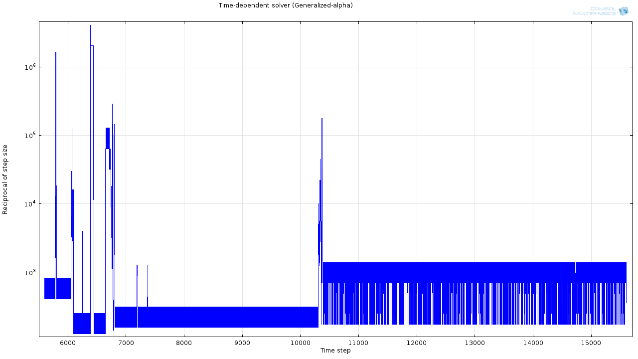

Particle tracing is conducted by a generalized-alpha solver.
For many cases, when the particle motion is finished, the time step is increased drastically.
However, in current case, time step is oscillating.
In some case, when I turn off the Brownian force (which is a monte carlo modelling), this problem is solved.
However, this is not a solution for the current problem.
What should I do for avoiding this problem?
This problem causes the longer solution time.

Hi Chang-Ho,
With Brownian force you COMSOL needs a small enough time step such that the random force is “applied” a sufficient number of times. If you loosen the convergence tolerances COMSOL will take bigger time steps.

Thank you for the rapid response^^
Is it also dependent on the particle number?
