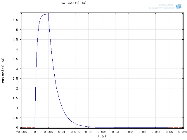

(2) The loaded current is shown in fig.1. When the time is 0-5 ms(denote as t1), the current ascends(I1), when the time is 5ms-50 ms(denote as t2), the current descends(I2).

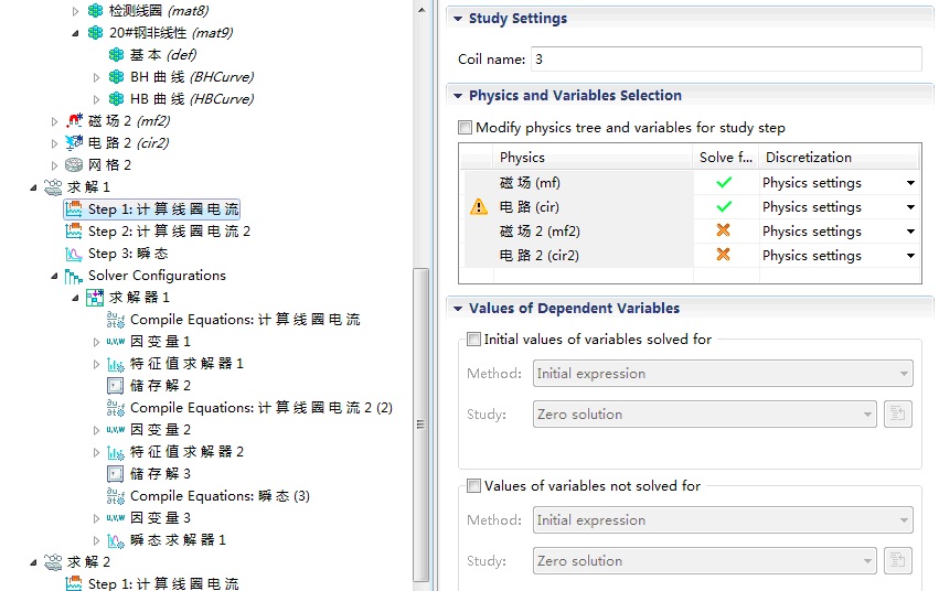

(5) The setting of solver 1 is the fig. 3: (a) is the step1: calculating coil current. (b) is the step2: calculating coil current 2. (c) is the step3: transient. The values of dependent variables are not to be chose.

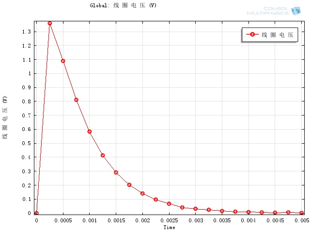

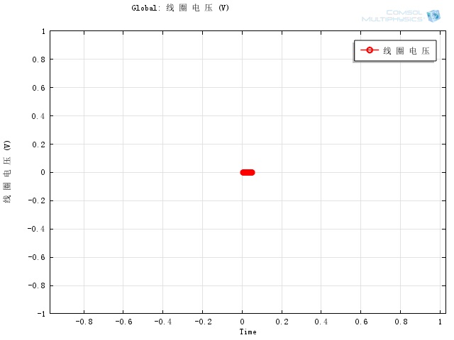

(7) Induced voltage curve of solver 1 is shown in fig. 5. It is right. The induced voltage curve of solver 2 is shown in fig. 6(a), the fig. 6(b) is the enlarged view. However, the results are all zero. It is wrong. Why the results are zero?
