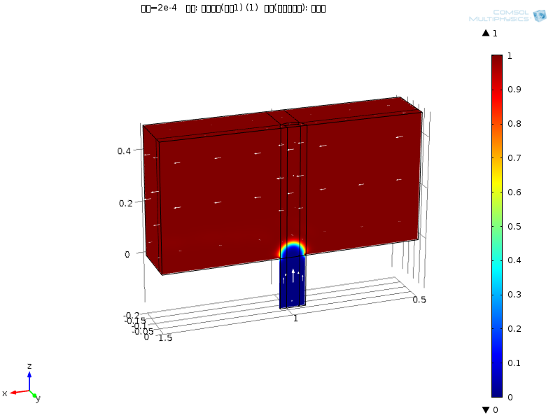

Modeling an MEMBRANE EMULSIFICATION
I am currently trying to model in 3D droplet formation by membrane emulsification method. But, the 3D simulation can not be formed droplet, I do not get good results.
The result was not changed since certain time step.
According to my forecast, the volume is not retained.
Therefore, I want to receive the advice to you about the cause the droplet is not detached.
Since I attached some of the results, I would like you to consider refer to it.
Thanks for the help.
