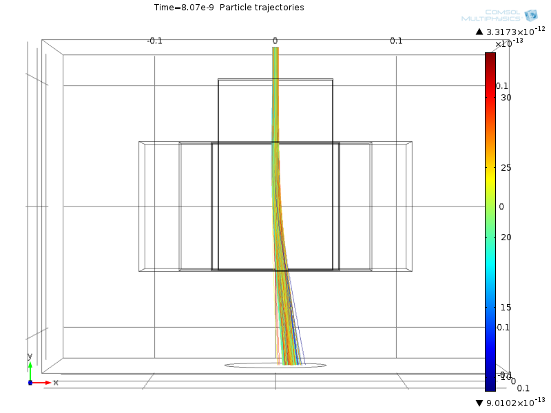

I am simulating particle tracks in a mass spectrometer. I would like to know the particle positions after they exit the magnet, i.e. when they hit a screen. I would like to make a plot with the two axes "x Position" and "z Position" (they are flying in negative y-direction). I attached a picture of my setup.

Hi, you can either make a Poincare plot or use the Phase Portrait to generate the plot you want. See the attached (V4.3b) model for an example on how to do this.
