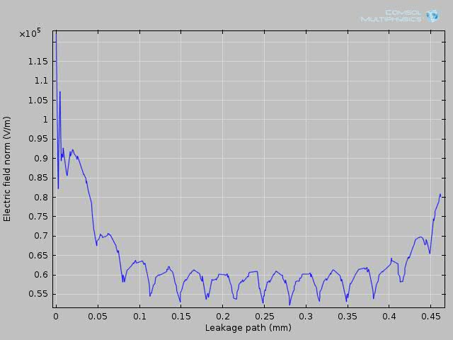

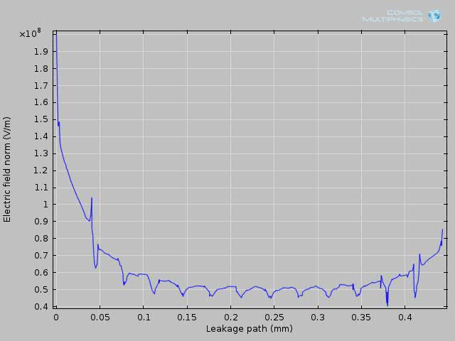

How can we merge the different graphs (Two graph) in COM SOL?
I work with comsol 4.3 AD/DC model( electric current), i have one problem in merge or combine two different model electric filed graph in one sheet. i attach my graph. How to combine it's.
Please help any one.

Hallo,
I see two ways:
The result noe "1D Plot Group" can have two sub nodes
("Table Graph" or "Line Graph") referring to two different data
sourcess. That means that you must have the two solution
in memory at the same time.
or:
Export the data to a file and use your favourite plotting
tool.
Regards
Jens
