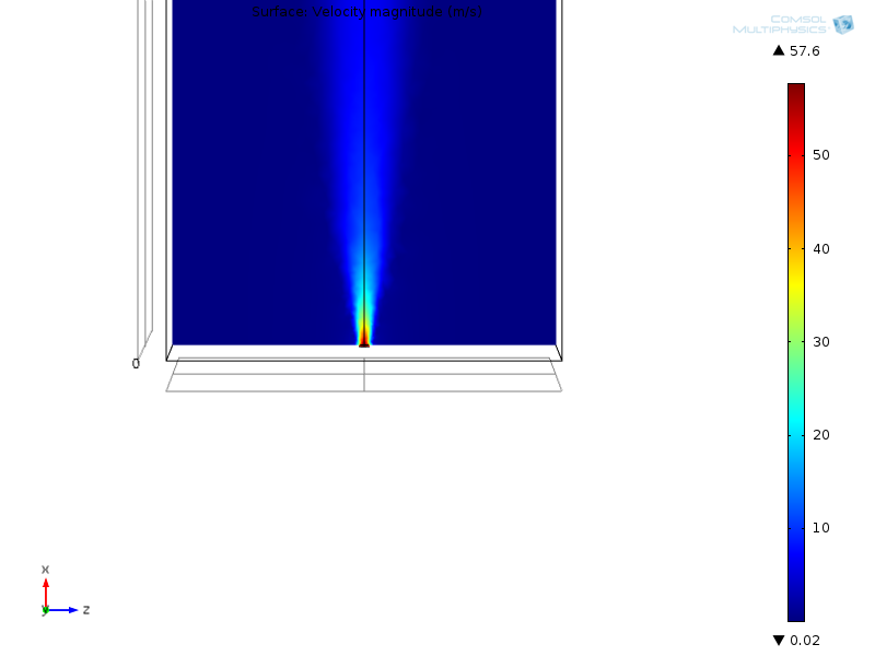

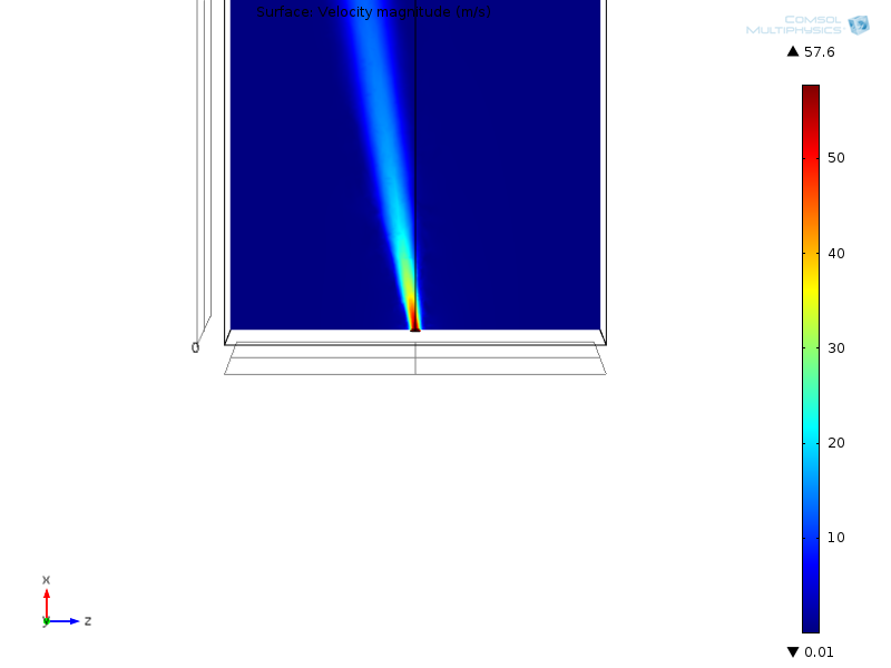

I am yet to decide between P1+ P1 and P2+P1..
I simulated a axi-symmetric jet using these two combinations.
I have attached the images of the results obtained. While P2+P1 provides significantly better resolution, the trajectory shows a unnatural deviation for P2+P1. The BC's for the two are exactly similar.
Any pointers on why this could be happening?
I am more inclined towards using P2+P1 and hoping there is a fix for anomalies such as these.
