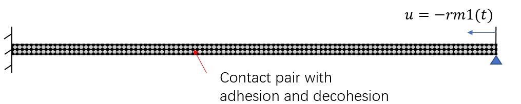

Anyway, my simplified model is set as follows.
The Solid Mechanics module in 2D domain is employed. A double bar, consisting of two individual bars in adhesive contact with decohesion law specified, is fixed at the left end, while its right end is prescribed to a ramped time-dependent displacement -rm1(t).

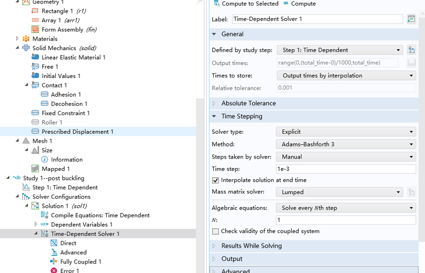

**The time-dependent sovler is adopted, and the 'solver type' in 'time stepping' is specified as 'explicit'.

We do not promote the use of the time explicit solver for general structural mechanics applications. The number of cases for which it is applicable is small. One of the limitations of that solver is the one that you have found. As the error message shows, you cannot have time-dependent constraints.
There are several other limitations.
Henrik Sönnerlind
COMSOL
We do not promote the use of the time explicit solver for general structural mechanics applications. The number of cases for which it is applicable is small. One of the limitations of that solver is the one that you have found. As the error message shows, you cannot have time-dependent constraints. There are several other limitations.
