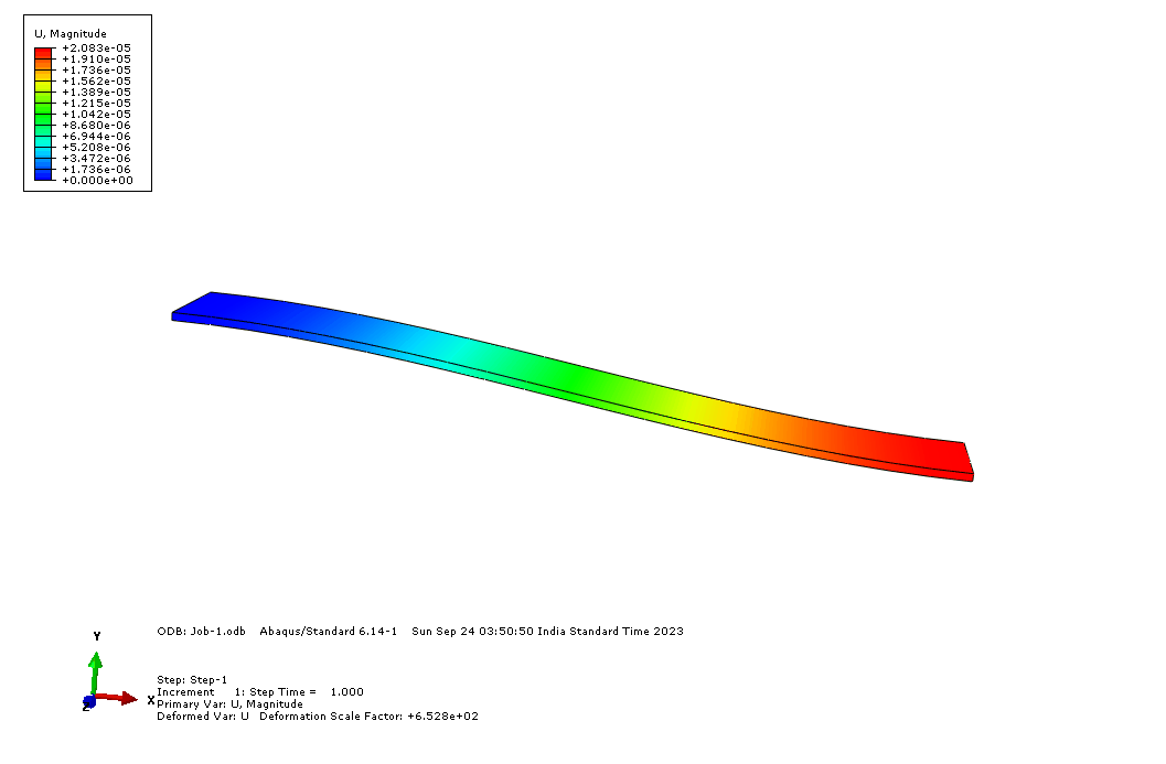

I am trying to do a static analysis of a cantilever beam whose one end is fixed.
In the other end I am applying forces axially and also in the transverse direction. But I what this end to be rotationally restraint, but can undergo an axial and transverse deflection. The final deformation of the beam will look somewhat like the attached figure.
While I am able to do everything else, i am not able to figure out! how to give a rotational restraint constraint. Someone please help!

Assuming that you are using Solid Mechanics, there are two direct approaches:
Approach 1:
Add a Rigid Connector to the end boundary and constrain its rotation.
Approach 2:
Add a Symmetry condition to the end boundary, and make use of the settings in its Normal Direction Condition section.
