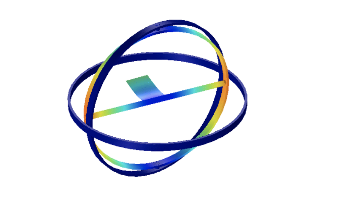

Plotting the angle of the corners of this flapping & rotating plate
Hi Guys,
This is a flapping and roatating plate used for simulating an insect wing. When this wing rotates as it flaps it creates torsional force. And, I wanted to plot the angle as a function of time of corners at the tip of the plate. The base has a fixed constraint. I just want tips on how to achive this and what data I need from COMSOL.

Dear Amanuel,
If you are looking for flapping motion with respect to the rotating frame instead of combined flapping and rotation motion w.r.t fixed/spatial frame, you can use Body defining reference frame functionality in the Multibody Dynamics interface. Here the rotating body can be defined as a reference frame and results can be visualized with respect to this frame.
Pawan Soami
Dear Amanuel, If you are looking for flapping motion with respect to the rotating frame instead of combined flapping and rotation motion w.r.t fixed/spatial frame, you can use *Body defining reference frame* functionality in the *Multibody Dynamics* interface. Here the rotating body can be defined as a reference frame and results can be visualized with respect to this frame. Best regards, Pawan Soami
Posted: 5 years ago 2 sept. 2020, 04:25 UTC−4
Wonderful! Thank you very much for the great tip! I will try that!
However, I actually wanted the combined flapping and rotation motion as a function of time (temporal). Any idea on how to do that?
