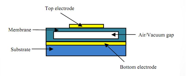

I don't understand how to setup Moving Mesh Physics for my cMUT model
any help please
any help please
