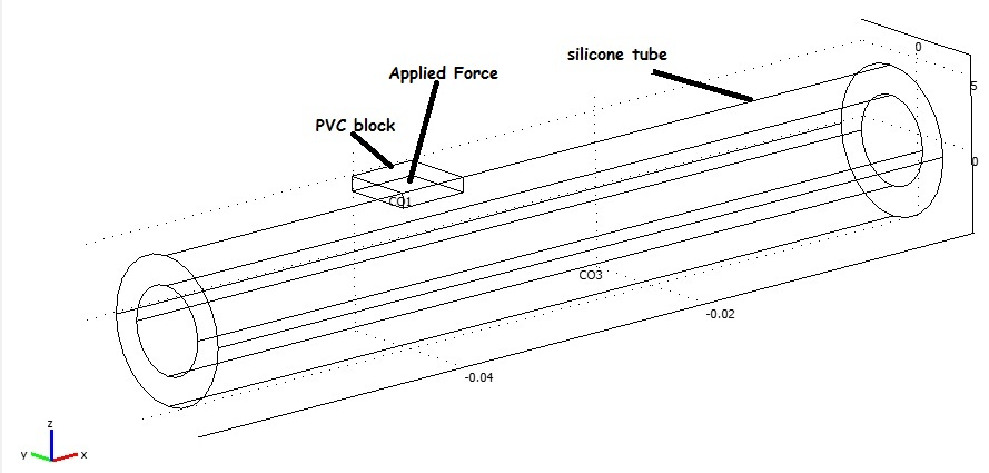

I would like to analyze the deformation of a silicone tube when an applied force "F" on a square piece located at the top of the pipe (see figure). What modules of the Comsol should I use ?

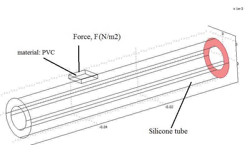

I would like to apply a force on the block of PVC and calculate the volume of the silicone tube varied due to compression. I'm using the module Solid-Stress-Strain (sld) = subdmain 1 is the silicon tube, subdmain 2 is PVC.
How do I check the deformation experienced by the tube due PVC block?

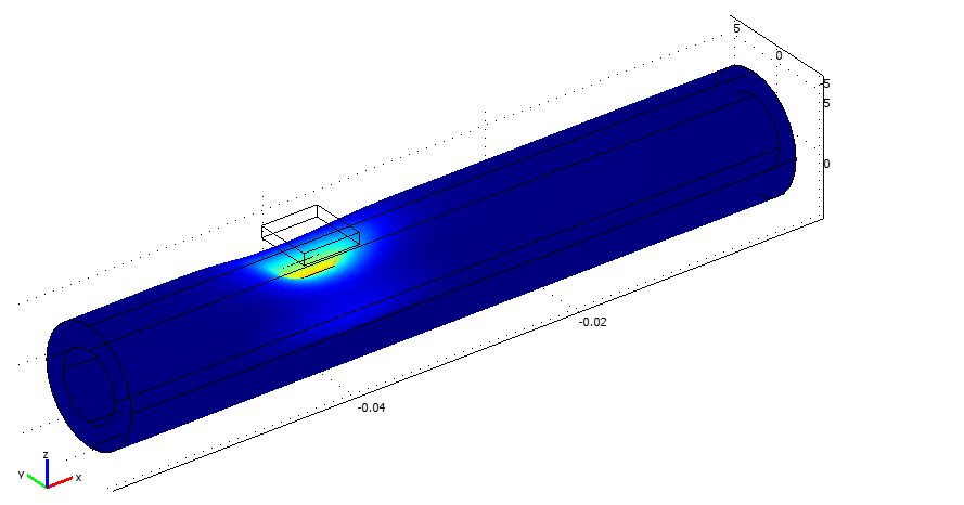

The block of PVC seems warped, but the tube nothing happens. I believe this is wrong.

I see what you have defined on the boundary loads ! That looks correct, but perhaps it's not what you wanted ;)
If you take the third-last image, there you FREE the lateral sides along "z" of your square pushing block you might see a far more important squeeze, since then the block may slide freely
What you see on the last image is the pushing bloc, with the lateral sides fixed, being bend by the applied load/pressure
