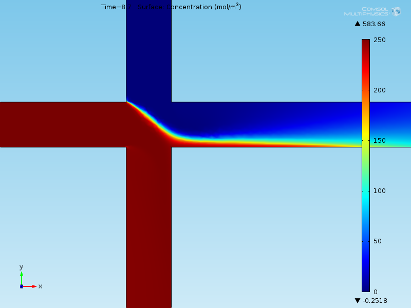

Hi:
I´m working in a 3D model of a pipe cross junction with different velocity conditions, about chlorine distribution throught de cross section (see attached image please). My model only consist of 2 inlets, 1 with clean water an 1 with a constant concentration of 250mol/m^3, and two outlets. When I run the simulation, I check the two outlets, resulting this:
Concentrations
inlet 1 = 0 mol/m3
inlet 2 = 250 mol/m3
outlet 1= 58.7643 mol/m3
outlet 2= 247.905551 mol/m3
A wanto to know if this is correct. I supose that the concentration sum of two inlets must be 250mol/m3, but the two outlets reach 360.66981 mol/m3. There exists other form to verify the continuity of species?

Your picture looks laminar flow. What is the Reynolds number? What are the dimensions of the picture?
Lasse
Your picture looks laminar flow. What is the Reynolds number? What are the dimensions of the picture? Lasse
